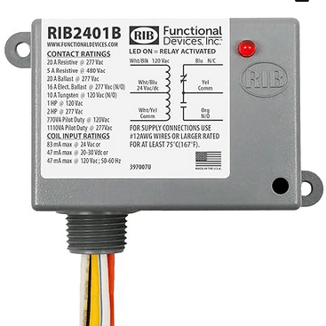

How about something like this?
Mounted on a Tee fitting, you can run the low voltage one way and the high voltage the other way.
Link to Page
