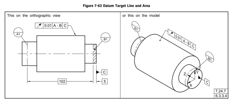

I keep running into these situations where the engineers want to designate a datum target point at a section of a hole. Say the hole is 1 inch deep, at .500 inches they want to use the centerpoint of that section as a datum target point. I can't seem to wrap my head around how this point actually constrains the part. In one of these situations, I have a planar face (primary datum) and then two holes that are perpendicular to the face. If I define one of these centerpoints in each hole, do I fully constrain all 6 degrees of freedom? I'm trying to encourage them to use the centerline of each hole as the secondary and tertiary datum because I know that works, but they don't want to do that.
Am I actually defining a spherical datum feature at each of these points?
Is using a "circular target line" a proper way to call out this case as well? the minimal content in Y14.5 2009/2018 doesn't give much guidance on how to use a CTL.
appreciate any help

A target line that is a circle is fine, I suppose, given that there isn't a description of what the part does or how it interacts with other parts.
If a plane and two bolts would keep the part aligned then a plane and two circular items jammed in the holes will do the same.
Edit: Technically, the contact is with the curve, which is the datum target; datum target are things that contact the surface or are tied to contact with the surface. There's a big opportunity right there for the well, accullally comments that don't need to be part of this.
The center is just the center of the circular target line (circle, in this case) and not an independent datum target point.
A circular datum target on a cylindrical feature is supported.
The following example from Y14.5-2018 is for an external cylinder but the same could be applied to holes of course.
And yes, one planar surface as the primary datum feature and 2 datum target circles inside holes that are normal to that surface as secondary and tertiary datum references would constrain all 6 DOF.
