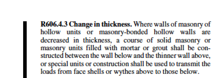

"I know it is common practice to grout the course below a thickness change in the masonry. Is this in the IRC or ACI530 anywhere?
This was discussed here where the long lost KootK questioned its necessity. I imagine the builder will be wanting not to do that."

FYI, found this in the IRC....
