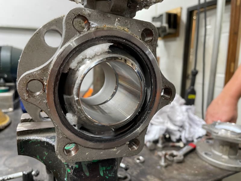

Update:
We've removed a valve and inspected it, with a picture below. It appears that monomer is collecting in the void between the ball and body and polymerizing in place. I think a plug valve would be the best way to prevent this. Diaphragm valves would also work, I think, but I don't think they have the same level of shutoff that ball/plug valves do.
If the cavity is the problem and you only need a unidirectional valve, look at a segment type valve, AKA C-Ball. Just a thought.
In this case globe valves are better as those have no voids and perfect tightening at reasonable cost. Check if piping hydraulic and layout can tolerate those.
I suppose ball valves have been choosen as those are full bore and therefore guarantee free draining/venting.
Note that an ultimate mean to prevent valves polymerizing is washing the stagnant points with a solvent (constant or prior valve closing). I have met such and I should warn you that this is the most expensive option.
