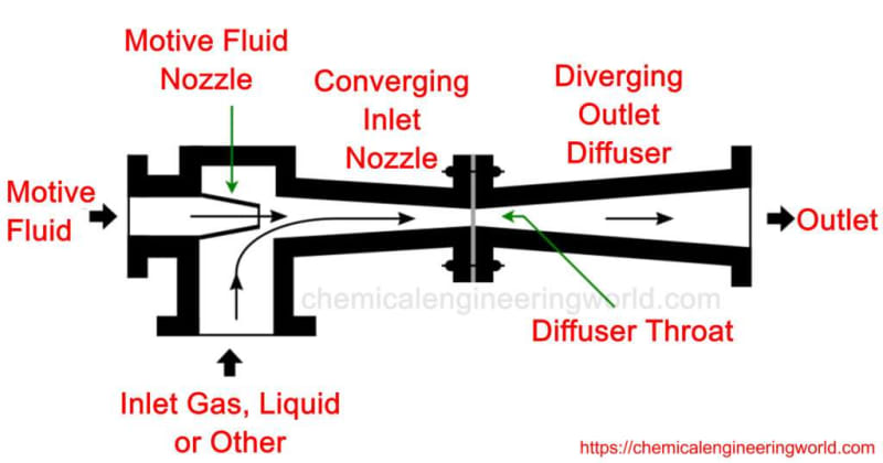

Steam eductors (also called ejectors) will do a great job of pulling a lot of air quickly.
You can get them designed to not draw a deep vacuum but simply to remove something like 1/2 of the air.
If they are going to cycle quickly you could have a small buffer tank to have them draw against when not connected to your main tank.

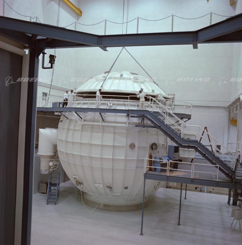

[segue] I can't find references, but I remember that McDonnell Douglas Huntington Beach has a HUGE vacuum chamber, 30-ft diameter, 39-ft height, I think, and the diffusion pumps are something like 6-ft tall and there were 3(?) of them. Still took gross amounts of time to pump down.
Oh, I found one picture; the things hanging off the left side are the diffusion pumps, I think
[/segue]
