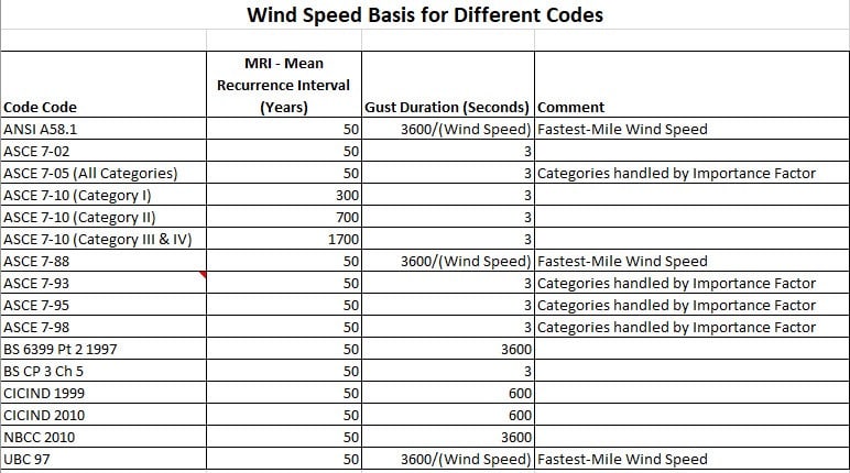

1. MRI-50 years for ASCE 7-05, 300/700/1700/3000 years for ASCE 7-10/16;
2. Importance factor;
3. Load factor.

For the ASCE 7-05 conversion indicated in API 650 (2013) above in paragraph k) first sentence, since the load factors and importance factors are not included to begin with in ASCE 7-05 wind maps, then the ASCE 7-05 maps are the true 50 MRI, 3-sec gust, 33 feet level, Exposure C values. Therefore, they do not need to be converted back using the 0.6 and 0.78 factors. However, conversion of the ASCE 7-05 maps require multiplying by the SQRT “I” (importance factor) as indicated. This is because the older API 650 standards, which the later API 650 standards are still based on, never did include an importance factor but based the wind speed on the Fastest Mile Wind Speed of 100 mph as previously indicated, which resulted in 30 lb/ft2 for flat surfaces and 18 lb/ft2 for cylindrical surfaces as previously indicated. The later versions of API 650 now are now coordinated to be consistent with the later ASCE 7’s as indicated in the API 650 (2013) excerpt above to use the 3-sec gust wind speed and importance factor as follows:
1) Use the wind basis as the 3-sec gust wind speed instead of the Fastest Mile Wind Speed. The 3-sec gust wind speed is approximately 1.2 times the Fastest Mile Wind Speed per API 650 (2013) part 4) above. Therefore, the new 3-gust wind speed basis, based on the 100 mph fastest mile speed of the older API 650 editions is now 1.2*100 = 120 mph. Keeping the basic design wind pressure per older API 650 versions at 30/18 lb/ft2 but normalizing these values based on the 3-sec gust speed, instead of Fastest Mile Speed, then the 30/18 lb/ft2 is multiplied by the 3-sec. gust value “V” per API 650 (2013) paragraph k) above using equation (V/120)2 as indicated in paragraph 1) above. By doing this the 30/18 lb/ft2 basis, based on fastest mile wind speed, has been adjusted based on 3-sec. gust wind speed “V” normalized to 120 mph 3-sec gust value.
2) Include an importance factor which the older API 650 did not include. To be consistent with the later ASCE 7 editions which use a 3-gust wind speed V with and importance factor also included, the basis wind pressure of 30/18 lb/ft2 also must be adjusted for importance factor before it is inserted into the equation (V/120)2. Simplified without showing the other factors this results in the ASCE 7 equation wind pressure is proportional to I(V2) or (IV)2 or SQRT(I)(V2). Therefore, to include the importance factor to the 3-sec. gust wind speed of the API 7-05 maps per k) above, multiplication by SQRT(I) is required. Note that for conversion of the ASCE 7-10 to ASCE 7-05 calculation the importance factor multiplication is not required since the API 7-10 maps already include the importance factors.

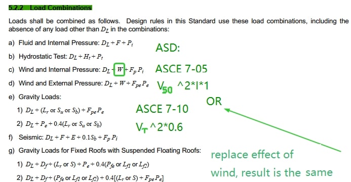

There are three possibilities per API 650:
5.2.1k) Wind (W): The design wind speed (V) shall be either:
— the 3-sec gust design wind speed determined from ASCE 7-05 multiplied by √I, Figure 6-1; or
— the 3-sec gust design wind speed determined from ASCE 7-10 for risk category specified by the Purchaser (Figure 26.5-1 A, Figure 26.5-1B, or Figure 26.5-1C) multiplied by 0.78; or
— the 3-sec gust design wind speed specified by the Purchaser, which shall be for a 3-sec gust based on a 2 % annual probability of being exceeded [50-year mean recurrence interval]. The 3-sec gust wind speed used shall be reported to the Purchaser.
The first option is for converting from ASCE 7-05 wind maps in which you just multiply by SQRT "I".
The second option is if you use the ASCE 7-10 wind maps for 300, 700 or 1400 MRI which I believe you must multiply by 0.6 (x wind pressure) or 0.78 (x velocity) which I spoke of in my previous post. Note that this will take out the added LRFD load factor of 1.6 but it will keep the importance factor since each Risk Category Map I, II, III, IV increased wind speed values are due to importance factor. So the importance factored value of wind speed is maintained even after multiplying by 0.6/0.78. What MRI maps you use is based on engineering judgement for the location involved.
The third option is a little tricky in what it is saying. I believe it is saying you can just determine your own 50 year MRI based on historical wind data collected for the location involved without any other factor 0.6/0.78 applied. If you really want, although it will be very conservative, you could even use the converted V50 value per the ASCE 7-10 calculation you previously posted (without any additional conversion factors 0.6/0.78 applied) as it will surely be greater than the actual V50 MRI for any given area I assume being that the 1.6 LFRD factor will still be included.

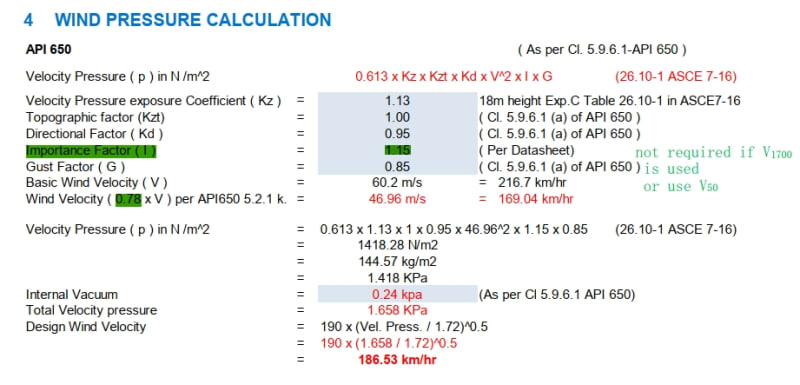

The question is that our project are not in the USA. We don't have any wind speed maps.

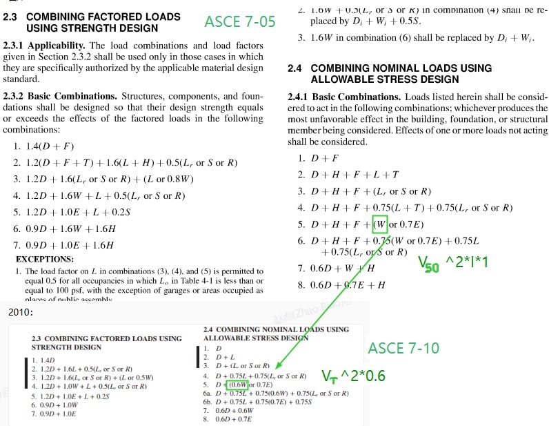

As shown in ASCE 7-05 & 7-10, take load combinations for stress for example. "W" in ASCE 7-05 and "0.6W" in ASCE 7-10 is of the same effect.
If now we have V[sub]1700[/sub] calibrated based on strength limit state and ASCE 7-10, the load effect is:
P=0.613K[sub]Z[/sub]K[sub]ZT[/sub]K[sub]D[/sub]V[sup]2[/sup]*0.6
Or as per ASCE 7-05:
P=0.613K[sub]Z[/sub]K[sub]ZT[/sub]K[sub]D[/sub]V[sub]50[/sub][sup]2[/sup]*I*1.0.
V[sub]50[/sub] is obtained as per formula given in Page 509, ASCE 7-10.
There is a wrong example: risk category III
Our mechanical engineer use V[sub]1700[/sub], divided by 0.78, (they think that V[sub]1700[/sub]/0.78=V[sub]50[/sub], and they think V[sub]T[/sub]/0.78=V[sub]50[/sub])
Then they use "V50" and consider importance factor 1.15 for risk category III.
This is also my understanding.

I am not that familiar with the ASCE 7 code and all the load combination you listed in your post above. However, the equation listed on your latest post above noted as 26. 10-1 ASCE 7-16 is the basic equation I am familiar with for use in calculation of wind load on mechanical equipment. My understanding that "V" in this equation is the 3-sec gust 50-year MRI wind speed without LFRD load factor or Importance Factor "I" included.
Therefore it is my understanding that to obtain "V" to use in this equation from wind speed maps for V[sub]1700[/sub] Risk Category III of ASCE 7-16 you would adjust as follow:
Multiply V[sub]1700[/sub] of Figure 26.5-1B by 0.78 to remove the LFRD load factor. The resulting "V" is now, as I understand, the V[sub]1700[/sub] wind speed which corresponds to the 50 year MRI wind speed but with importance factor of Category III based on ASCE 7-05 editions still included.
Therefore for use in the equation indicated above you would not need to multiply by "I" since "I" is still included in the converted velocity. Multiplying velocity by 0.78 only removes the LFRD load factor added to ASCE 7-05 wind maps to obtain ASCE 7-10 and above wind maps but does not remove the Importance Factor, which was also added to ASCE 7-05 wind maps to obtain ASCE 7-10 and above wind maps.
