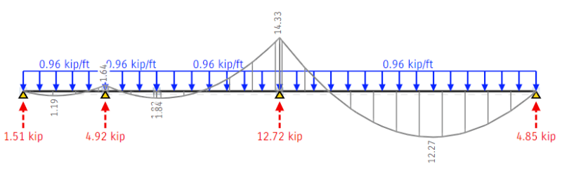

I'm hoping to get some advice and a sanity check on a few things. In my spare time, I've been starting to plan repairs for the first level framing of my own 100+ year old home. For background, I'm a licensed structural engineer (PE not SE) with about 5 years experience in heavy industry. I work with steel and concrete. My experience with timber design is limited to one undergrad class and sizing a handful of beams and crane mats--so very little practical experience. Virtually zero experience with residential. I'm trying to crunch some numbers so I have a better feel for what's going on in my house and planning to hire a local contractor for repairs.
See attached pdf for a drawing of my house, NDS calcs for a timber beam, and some photos. Below is what I hope to get a little help for:
1) At least one 2x8 floor joist is failing/splitting (photo 1). Joists are old-growth full length 19-20 ft, spanning over a 6x8 timber. No bridging or bracing. I still need to analyze joists per NDS, but I'm planning to sister the failed joist (and a few others) as full length as possible. Anyone see issues with sistering the old joist that is cracked per photo 1? I'll need to reroute electrical. I think I will also install bridging between joists where it's feasible. Some shoring/jacking will be required for this work. I'm assuming driving nails into old wood will be very difficult.
2) My 6x8 timber beam appears to be failing in bending at 350% utilization per NDS... Trying to be conservative, I assumed Douglas Fir-Larch No. 2 with Fb = 750 psi and Fv = 170 psi. Assumed DL = 20 psf and LL = 40 psf. I believe beam is picking up load from second floor as well. Beam is continuous over an S6 steel post at midspan. I assumed pinned-pinned at end connections. Perhaps that's wrong as beam is embedded in concrete wall. Could I call it fixed-fixed to reduce my moment to 7.6 kip-ft? Also, am I being too conservative with assuming No. 2 and Fb = 750 psi? I don't know what's reasonable for a 100+ year old timber.
3) The 6x8 beam has some other issues I want to address. It has a big, ugly notch (photo 2) from an old duct a few feet west of the steel post. I believe notch should be in compression, but it's not code-compliant and definitely not helping my flexure check. I'd like to sharpen my pencil on bullet point 2, and then I can design some reinforcement for that area, perhaps by building a U-shape from 2x lumber to nail from underneath. The beam also has some fairly significant checking (photo 3) on one face only for about 12 ft, starting at the steel post and running east. The other face of the beam has very minor checking. Checking is about 1/2" wide; I can stick my fingers in it. Could this checking be from a more serious issue than from regular drying/shrinkage?

Thanks for the insight ChorasDen. I did review the NDS section about notches, but I'm not sure if I can get it to apply to my scenario. Maybe I'll leave the existing beam analysis as is and move on to reinforcement design. I can only sharpen my pencil so much. And perhaps you're right about the checking/failure on the east half. I'm not really sure how to address it besides reinforcement.
Attaching more photos of the beam for perspective--had to compress photos, so they're a bit grainy. There are a lot of things that are going to get in the way of full length LVL reinforcement. Chimney, water heater, furnace, steel post and cap plate, utility room, pipes, and electrical...some are moveable, some definitely aren't.

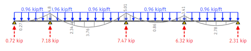

I'm currently thinking the best I'll be able to do this is take (4) +/- 12'-0" LVLs (1-3/4" x 9-1/2" perhaps) and sister them on both faces of existing beam on either side of the midspan post. Still need to run these numbers. I'm also considering adding a new post to break up the 12'-6" east span in half. I'll need to be careful about point loading my slab, but it will reduce bending in the beam significantly. See below for existing FBD and proposed FBD with new post. Going to sleep on this for a bit.
Existing: (wood post at 4.92k reaction; beam notch at M=1.84 k-ft)
Proposed: (new post at 6.32k reaction; beam notch at M=2.34 k-ft)

These calculations are in Mathcad Prime (I have it at work). My free body diagrams are made in Strian (link: [URL unfurl="true"]https://structural-analyser.com/[/url]). It's really nice for indeterminate structures.

Are there footings under the current posts? I would slam another post under there and be done. If it cracks (unlikely), add a footing later.
I do this a ton and by the looks of this beam I wouldn't even bother with it. Your joists aren't even lapped over top here so it's even easier to just add a new LVL right next to it. Shoring wouldn't be needed in that case. You can always add new 2x8 joists to sister any damaged ones.
If your floor is really sagging you can take the risk of jacking it back up first, but if not, just add a new LVL girder and posts right next to the existing one. Put a post right up against the wall on each end to avoid bearing the beam on the wall.
Drill a 1/2" hole in your floor slab and take a wire hanger to see how thick it is. As long as you have 3.5"+ you should be good without it cracking for a long time.
If you wanted to add a footing(s) it shouldn't be too expensive. I had a mason friend do it on the weekend and I think he charged me $500 or less to cut the old footing out and pour a new bigger one.

jerseyshore & kipfoot, I think we're all starting to funnel down to a good solution that's somewhere between overkill and not giving a rip. I've gone from "oh crap my house is falling" to "ok maybe this isn't too bad, and a reasonable fix is available." My wife won't like it, but I think a post is the way to go; it just reduces my moment too much to ignore the advantage. I will add a footing. At the same time, I'd still like to sister/reinforce the beam with either an LVL or 2x...if for no other reason other than to hide give the appearance that I have a beam without visual flaws. As kipfoot mentioned, I am thinking of future owners as well. This is not our forever home. We have a couple young boys and can tell we'll be outgrowing this house in a few years. I'll still crunch my numbers and make the math work--I want to and will do this right; but I don't think I need to do anything over the top.
