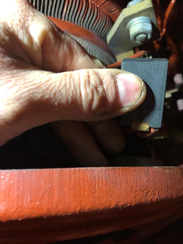

Too dark a patina indicates poorly made or incorrect grade of brushes.

Hello Muthu,
Is there a way to know if the brush is of the wrong grade for this motor?
The dark patina couldn't it come from the brush getting settled ?

A patina that dark in such a short time is anomaly. Check the OEM brush grade and replace with the same grade. I think the present grade has too much carbon content.

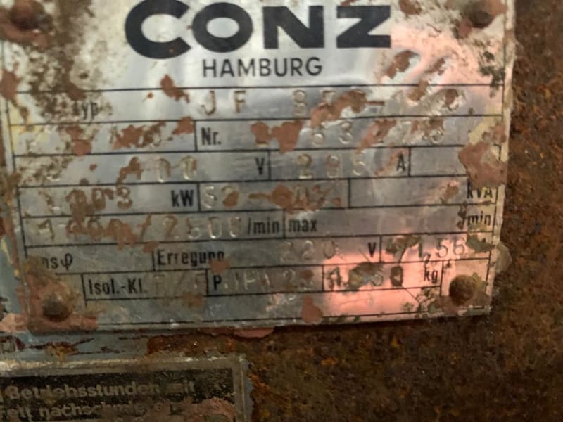

I don't know if this are compound motors, I have to ask. On the Motors nameplate I can't read a lot.

I will ask if there is a part list about the motor mention what kind of brushes this DC motor uses.

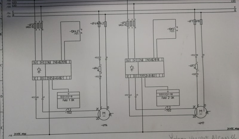

Hello Bill,
I uploaded the electrical diagram in the previous post. Connection diagram of the motor on the motor plate, like on some induction motors, I can't find.

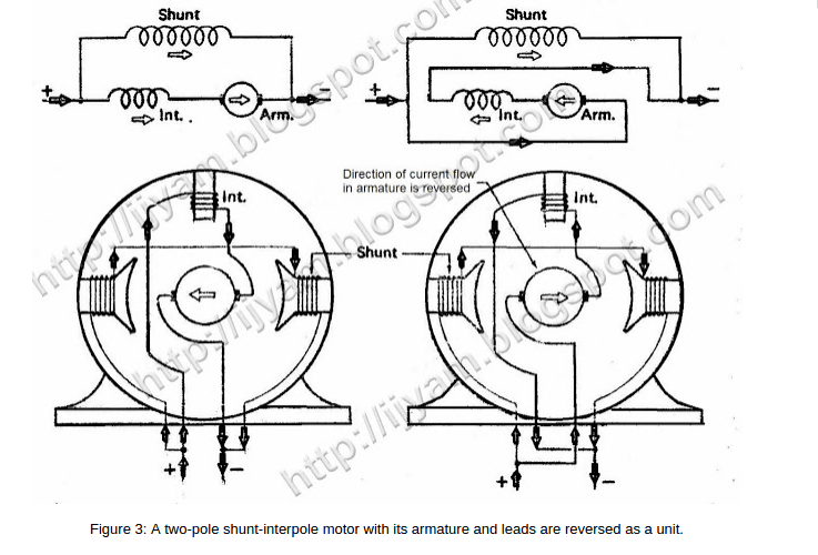

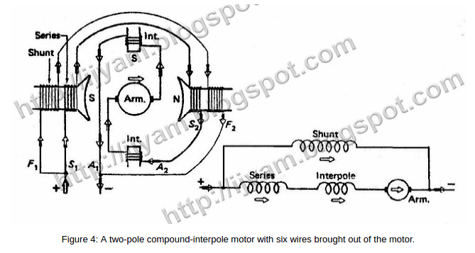

Some useful information on DC Motors can be found here, along with the two pictures following.
The first picture shows how interpoles are connected to the armature circuit, This is the arrangement I would expect with a DC crane hoist, having a solid state or Ward Lenard type speed control.
This is a two pole compound motor. This arrangement provides very good speed regulation, making this arrangement less useful for crane hoisting applications.
As you can see in both motor types there are many connections, all of which must be correct.

The wiring diagram by OP doesn't show a compound wound motor.
Agreed, Thanks for the catch Muthu.

Fred, That diagram seems to show the series winding wound in the same direction as the shunt winding.
That is a common connection for a compound generator.
Under load, the series winding increases the field strength and causes a voltage rise to compensate for voltage drop on long feeders.
For speed regulation the series field is differentialy connected to oppose the shunt field and increase the speed by field weakening.
If that connection is used on a motor it will boost the torque under heavy loads, but the speed regulation will be poorer.
Bill

Of course The diagrams in my previous post are for the simple case of motor across the line, I put them here to possibly aid the lack of detail in the wiring diagram provided by the OP. I perhaps did not pay enough attention to the coil winding artwork.
Regards
Fred
