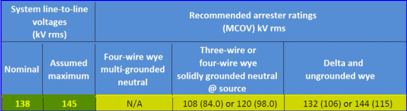

Below is a frequent range of arrester rating recommended by NEMA.

Thanks for the reply guys. Putting more context to my original question, table posted by Cuky (thanks for the table btw) has a range for solidly grounded system i-e 84 MCOV or 98 MCOV. I am curious if its only TOV capabilities of the arrester that drives the decision to choose between these two or there are other variables to look at?

Yes, temporary overvoltage (TOV) is an important factor to consider since this condition imposed overstresses (thermal overrun) in the arrester. Under any circumstances, the arrester MCOV should never be decreased below the steady-state line-to-ground voltage of the system. Due to the specific TOV level, the arrester MCOV may need to be increased accordingly. A simplified way to address this issue is by adding an adequate protective margin varying from >15% for switching surge & > 20 % for FOW and lightning surge.
Among other factors, the arrester's energy capability needs to be taking into consideration. If more accuracy is desired to select the arrester, and insulation coordination study could be an option but difficult to justify the cost for a small project.
Hi Bill: If the system impedance is known, it is possible to determine the " Coefficient of Grounding". Solidly grounded is defined as 0< X0/X1<3.0 and 0<R0/X0<1.0.
The table posted by cuky doesnt seem to provide a range for arresters ratings but more likely just suggests two consecutive catalog ratings (for different security margins I assume).
I dont know about ANSI/IEEE standards, but IEC states that the minimum MCOV for a solidly ground application should be at least: 1.05*Umax/√3 (for the 138 kV example it means 1.05*145/√3 = 88 kV aprox).
The 1.05 "safety factor" covers possible voltage wave distortion and unbalances.
Thats the first step, you later check TOV capabilites and finally verify you got an adequate protective margin as cuky said.
