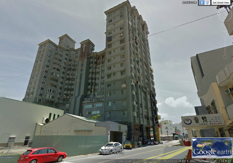

Looks like a short seven stories.
Does the reinforcement look small?
Suspect substandard construction, weak concrete, improper reinforcement and stirrup
Regarding "Looks like a short seven stories"?
The building is on its side.

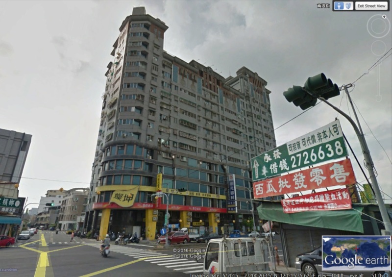

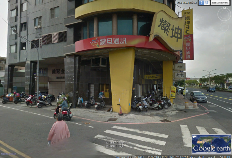

These are the pictures of the building prior to the earthquake from google earth.

I don't often deal in seismic, however, this looks like a case of "Soft First Story" behavior?
The picture provided by bimr at 02:10 looks like the stories above are displacing in a separate direction from the first...
This building fell like a tree cut with an axe. Either most of the first floor columns collapsed or ground liquefied. There was a massive failure of some sort, not just a few columns.
