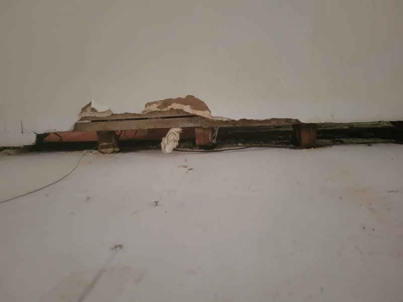

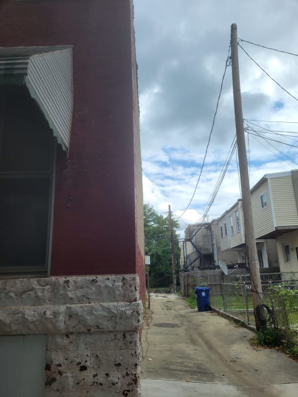

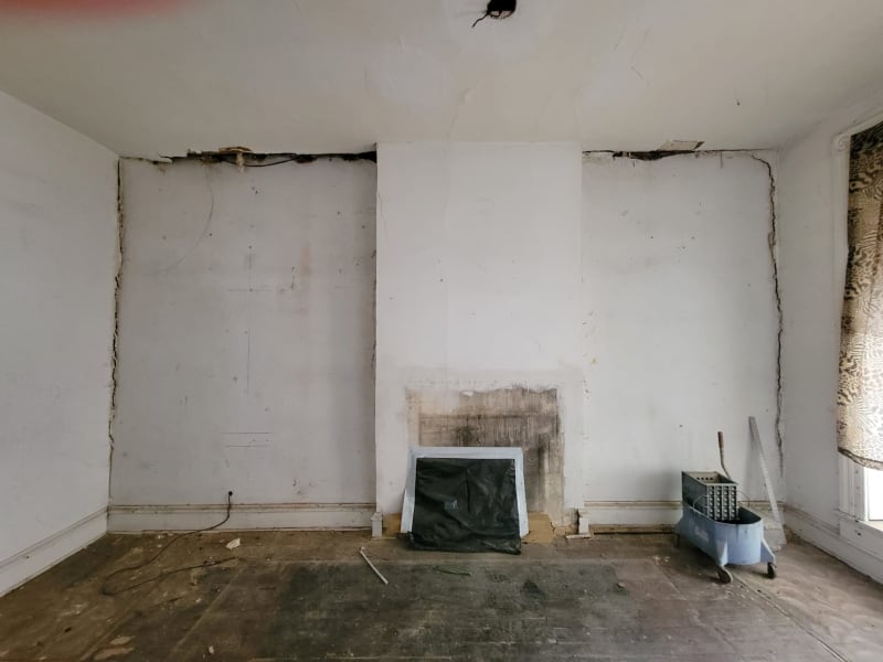

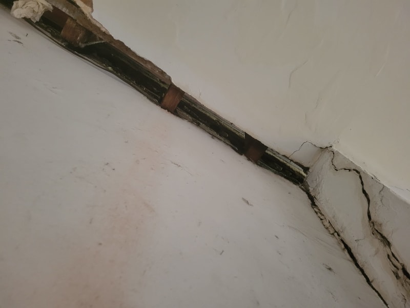

I started this thread to try to gain knowledge before I actually take on this job. I asked the realtor to send me photos of the condition. I have not been to the site yet. I am still trying to figure out if I should take this on. Here are some of the photos that the realtor sent to me.
My guess is that the only thing holding those floors up is the chimney breast so they had better not start knocking that down...
That looks like >100mm of displacement??
Difficult to see if the joists are actually free flowing, but I would get some props in there today and advise a closure of that alley way.
Any photos of the beams close up? - without putting a ladder against that wall.
That really looks absolutely horrible. It may even be a call to the local authorities / building inspector to make their decision.
Yikes. That one is pretty bad. Temporary shoring needs to go up quickly. I also agree with LittleInch regarding the chimney. That's what has saved that wall so far. It's likely going to be a rebuild.

1) Shoring to stabilize the wall. With these it can be difficult to tell what is actually holding things up. Like I mentioned above, some times it's the plaster. Shore the floor/roof above as well with enough room to get at the wall.
2) Demo finishes so you can see the joists going into the wall and the interior condition of the wall itself.
3) Assess the joists, their connection to the brick (likely non-existent), and the brick itself.
Lack of maintenance of the mortar, particularly if there is a leak, can cause the wall to shift. There really isn't a way to shift it back - the mortar that once held the wall in position is either gone or not capable of rebounding into its original position. If it can't remain as is with some good repointing, it has to be rebuilt.
