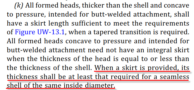

The following welding detail is for attaching a 2:1 head to a shell. Does ASME BPVC Section VIII, Division 1 prohibit such a configuration?

Thank you for your comments. In this case, the required thickness for both the 2:1 head and shell under internal pressure is nearly 10 mm. However, under full vacuum conditions, the head requires about 13 mm and the shell requires 23.5 mm. When looking into UG-33(i), it states, “The required length of the skirt on heads convex to pressure shall comply with the provisions of UG-32(k) and UG-32(l) for heads concave to pressure.” So I referred to UG-32(k) and found the last sentence, “When a skirt is provided, its thickness shall be at least that required for a seamless shell of the same inside diameter.”
Therefore, my query is if I have the SF as marked in the figure, and the thinner portion (19 mm) of the SF also meets the required thickness for internal pressure conditions (i.e., 10 mm), could I say the straight flange meets the external pressure equirements in the Code?

The section marked with SF whose length is 100 mm in figure is part of cylinder(shell) geometrically and hence it needs minimum thickness of 23.5 mm. It doesn't matter if we manufacture is as part of shell or head, it is cylinder and it needs to be at least as thick as the shell. When the code says 'at least that required for a seamless shell of the same inside diameter' it is implied as maximum of thickness required for internal/external pressure or any other load case for that matter and not just internal pressure. Hope this clarifies your doubts.

This is false. A shell with no RT (E=0.7) will be thicker than a straight flange (skirt) designed as a seamless shell (E-0.85).
I agree. Didn't think of effect of E on thickness calculation. Thanks for reply.
