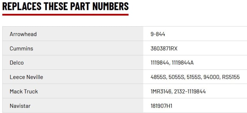

The Delco 11119845 series parallel 24Vcrank-12Vcharge solenoid
3 stage, two sets of NC contacts and one set of NO contacts, which is another style of wiring two 12V batteries in series for 24V starter cranking and 12V charging/run. The starter load is on the red cable on the right mislabeled "volt starter solenoid", the running loads and charging system would connect on the 12V(+).
Some 3 stage solenoid models (drawing in the post above), so equivalent models can be sourced.
Won't work for continuous series connection charging and use though.
