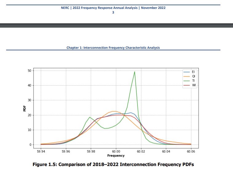

Thanks for the clarification crshears. I had misunderstood that the withdrawal of BAL-004 did not actually mean the end of MTEC. I am confused what changed since NERC posted the BAL-004-0 White Paper Clean suggesting to terminate MTEC.
This image from the 2023_FRAA_Report_Final shows the typical frequency distribution for the major interconnections in North America.
Administratively I'm not sure whether all the eyes have been crossed and the tees have been dotted, which also confuses me, bacon . . . but paperwork doesn't always comport with reality, at least in my experience.
CR
