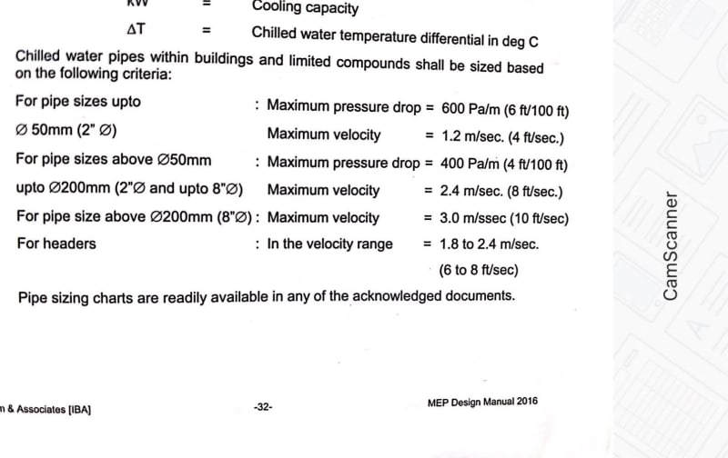

@LittleInch ,In this conversation, I'm writing about chilled water systems. The project's consultants in Dubai offer guidelines based on ASHRAE rules in their manuals for chilled water pipes. Accordingly, pressure drop is the main concern between 2 and 8 inches, and velocity becomes the main factor above 8 inches.

In the same units it's volume per second divided by the inside area of the pipe.
A simple spread sheet can give you that.
Those guidelines though are exactly that.
They may well be valid for certain building design, but you can't use that for all situations.
And why 28"pipe? Sounds like someone is taking this guidelines to place it isn't intended. It says " maximum " velocity. So choose a pipe size you can actually buy Like 30".

I am currently engaged in a live undertaking involving plant expansion. The consultant suggested a chilled water plant in which they advocated increasing the pipe size of the existing condenser water pipe, which is 700 mm (28 inches), with one cooling tower cell with 12,000 gpm (757 l/s) and another pipe of 700 mm for 18,000 gpm (1135 l/s). As part of the client-side evaluation, I just assessed the velocity of the lines. The velocity of the lines is 6.5 feet per second (1.9 meters per second) and 9.6 feet per second (2.9 meters per second) at 12,000gpm and 18,000 gpm. The velocity is below the limit, and I have asked the project consultant to explain the engineering behind the decision to increase pipe size.

So have you heard back from the consultant yet about the rational for increasing pipe size ? It may be due to some pressure drop limitation.

@1503-44 -Selecting 30 inches If it were a new project, I would agree, but this is an expansion of an existing project, and the practical issues are that the piping work and plant room in the third basement were already finished and connected to the cooling tower area from the third basement to the ground floor, awaiting the arrival of the second cooling tower. Currently, they suggest modifying the plan in conjunction with other MEP duties. It entails civil work such as expanding the concrete slab where the subjected cooling tower inlet pipe is taking place, which necessitates the devastation of client pockets for no good reason.
