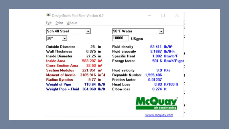

Perhaps my language is insufficient to persuade the subject in question. I apologise. The subject at hand is not just how to connect 28-inch pipe to 30-inch pipe. This project's new consultant is distinct from the previous consultant who were the principal designers of the complete plant. The new consultant advice to replace all including headers!!!Please keep in mind that the consultant proposes replacing the current full-length 28-inch pipe. That is, from the ground floor to the 3rd floor basement where the CHW plant (21,000 TON) is laid out! They recommend replacing the complete 42-inch (1000-mm) header! Leave the header issue alone and concentrate on the 28-pipe work, whether required by engineering, the ASHRE code, or an industry standard. Do you agree, even without knowing the technical justification?

I dont see why this program should not permit the rating check of 28inch pipe. It is non standard, but a cautionary footnote should have sufficed. A pipe mill can supply you non standard dia pipe if you order sufficient length to justify the production. Otherwise, there should be an option to manually input a given pipe id in this program.
It's free software from the manufacturer of pipes, so I would think that their primary interest is in sizing problems with their piping products as the solution

The McQuay design tool operates correctly and has access to all variables. This guarantees that the velocity and friction loss are both kept within the proper limits of the current design. According to ASHRAE, HVAC system velocities between 10 and 17 ft/s do not result in pipe erosion or noise.
18,000 US gpm with 28 inches of pipe
Schedule 40
Velocity: 9.9ft/s(3 m/s)
Friction loss: 0.83ft/100ft
hydraulic radius of 6.4 inches
