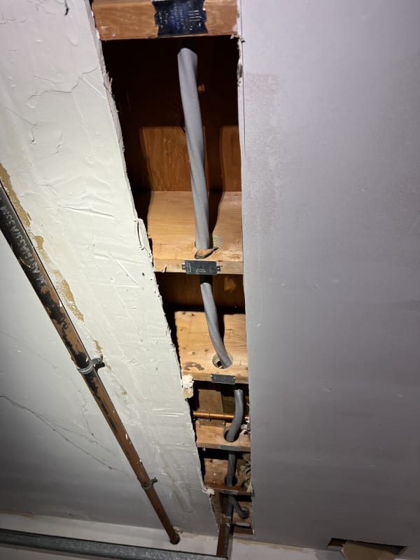

I’m a mechanical PE and could use some advice on the structural repair of a botch job an electrical contractor did at my house. I’ve attached some photos for reference.

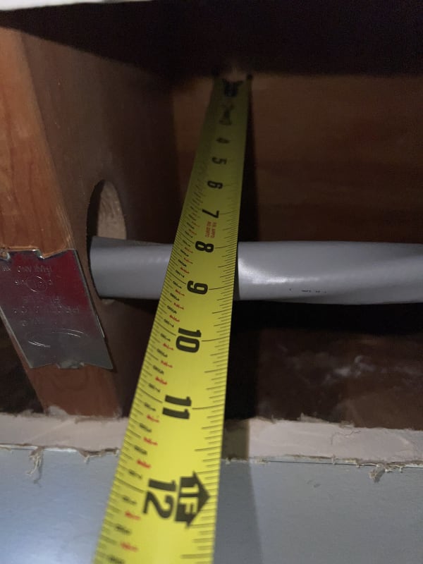

I have about a dozen 2x10 floor joists over my garage. The kitchen is directly above the garage. The 2x10 joists have a span of approximately 17’-6”. An electrical contractor bored 2-inch diameter holes through the bottom section of the beams all the way across my garage. He installed a 100-amp subpanel on the other side for EV charging. The holes left about 1/2” of “meat” between the lower quadrant of the hole and the bottom surface of the beam. The holes are about eight feet from one end, positioned in the middle third of the beam. In effect, the electrician turned my 2x10s into 2x8s.
I’m in King County, Washington State, where the IRC is applicable. The IRC says no holes in the upper/bottom two inches of the joist. The inspector did his inspection via camera phone (didn’t even look at the joists) and passed it. I didn’t notice the issue until after the electrician left site (shame on me - wife says it’s my fault, but then again isn’t everything).
I will be proceeding with a repair for peace of mind, if nothing else. I don’t like the idea of reducing the load capacity of 2x10s that were already probably at max span. Especially not in my kitchen where people tend to congregate during social events. I’ve contacted the contractor but haven’t heard back yet. If he doesn’t agree to pay for the repair, he’ll be hearing from my attorney. I’m a forensic engineer, and as much as I don’t like to admit it, I know several dozen.

1) That measurement looks more like your beams are <2 x 10, more like 2 x 9?? what's the actual width of the beam?
Also what is left is about a 2 x 6 1/2?
And in cutting away the plasterboard, he's nicked into the beam by about 3/4", right where the tension path lies?
what are those little itty bitty plates? Who banged in those?
Good luck trying insurance for something like this - not sure they insure for poor workmanship. Better off going after the inspector for passing what is clearly a bad job.

what's to the left and right of the beams when you look along them? Bound to be some cross bracing somewhere, but any other services?
LittleInch - it's a 2x10, which is 1.5"x9.25" from the mill, often slightly shorter after it's dried out more in service. Those little plates are just to keep the drywall guy from putting a nail/screw through the cable.
I'm with XR on the 2x8s. Off the cuff, I'd say an 8' 2x8 at each joist, centered on this spot. Then I'd run a couple of long self drilling (or pre-drilled) screws through the 2x10 on either side of the hole to keep it from splitting around the hole.
That loose knot is a doozy.
The beams are 2x10 nominal, which is 1-1/2” by 9-1/4” actual. There is about 6-1/2” material left in the beam above the holes, so the beam is effectively 1-1/2” by 6-1/2”.

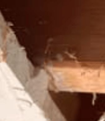

I don’t see any nick's in beam where he cut away the gypsum board. That’s not an issue.
The metal plates in the photos are nail guard plates. They are required by the building code. They prevent people from accidentally driving a nail into a 100-amp feeder; i.e., they are not structural.

There are no other holes through this beam to the left or right. No cross bracing either, as far as I can see. There’s insulation between the hard lid and second floor, so you can’t see much.

SeattleME - 6.5" to the top of the hole, but what about the top of the cable? If you can fit a 2x8, that would be best. Might need a pair of 2x6s? Have to run the numbers to be sure, but of course that goes for either case.

There’s about 7-1/2” clearance above the cable.

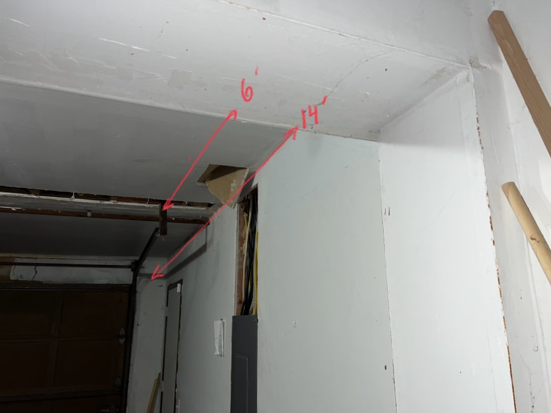

I just went down and remeasured. The span is 14 feet. The place where they effed up the joists is at 6 feet (see photo).

Just to close this out these are the 1/2" nicks evident where the guy cut the plasterboard / dry wall.
for a 14' span, (1)2x8 would be fine.
