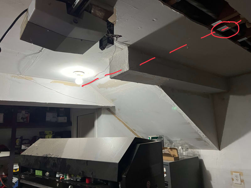

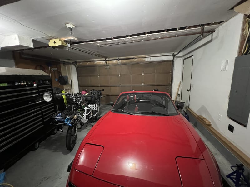

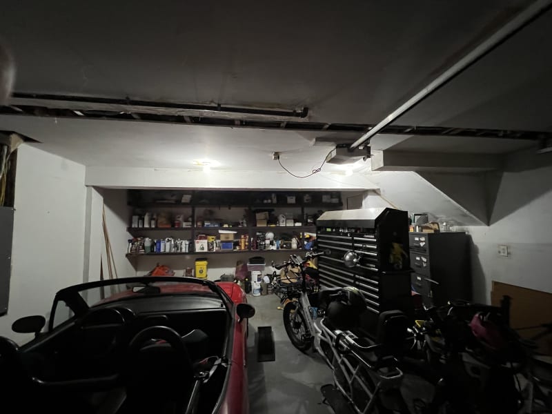

Hi Everyone,
I’m a mechanical PE and could use some advice on the structural repair of a botch job an electrical contractor did at my house. I’ve attached some photos for reference.

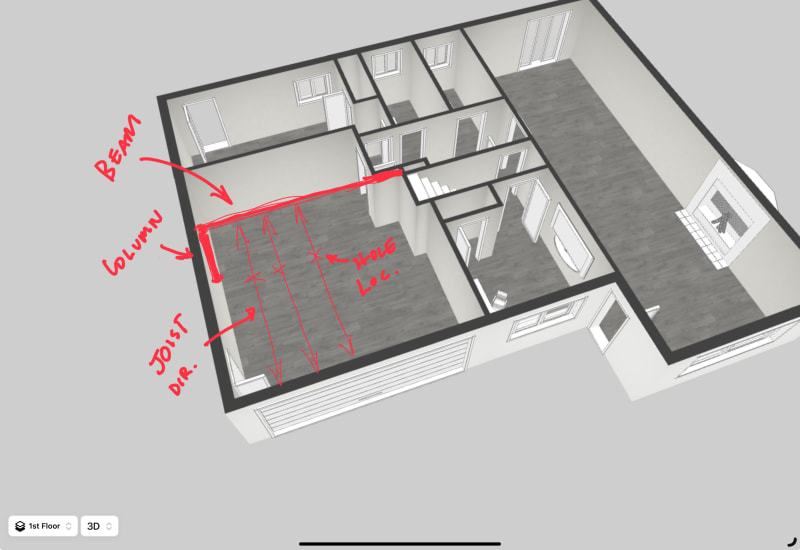

I have about a dozen 2x10 floor joists over my garage. The kitchen is directly above the garage. The 2x10 joists have a span of approximately 17’-6”. An electrical contractor bored 2-inch diameter holes through the bottom section of the beams all the way across my garage. He installed a 100-amp subpanel on the other side for EV charging. The holes left about 1/2” of “meat” between the lower quadrant of the hole and the bottom surface of the beam. The holes are about eight feet from one end, positioned in the middle third of the beam. In effect, the electrician turned my 2x10s into 2x8s.
I’m in King County, Washington State, where the IRC is applicable. The IRC says no holes in the upper/bottom two inches of the joist. The inspector did his inspection via camera phone (didn’t even look at the joists) and passed it. I didn’t notice the issue until after the electrician left site (shame on me - wife says it’s my fault, but then again isn’t everything).
I will be proceeding with a repair for peace of mind, if nothing else. I don’t like the idea of reducing the load capacity of 2x10s that were already probably at max span. Especially not in my kitchen where people tend to congregate during social events. I’ve contacted the contractor but haven’t heard back yet. If he doesn’t agree to pay for the repair, he’ll be hearing from my attorney. I’m a forensic engineer, and as much as I don’t like to admit it, I know several dozen.

What an awful thing to have happened to an engineer with structural knowledge. Two things to consider:
1) What you have now is worse than a 2x8 because a real 2x8 would be properly graded such that it would not have defects near flexural tension edge. You could, I suppose, have a lumber grader come in to check out the situation.
2) Partial length sistering usually requires a gaggle of concentrated fasteners at the ends to transfer the shear out of the reinforcement and back into the piece that was reinforced. In my experience, when left to their own devices 100% of contractors and 70% of engineers will not do/specify this.

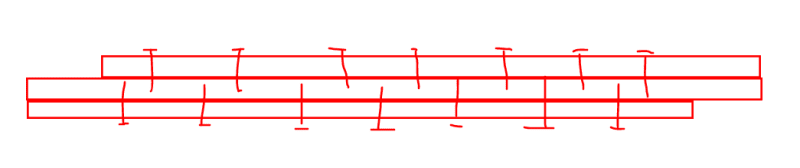

For sport, I'm going to tell you what I would want if this were my house without worrying about whether or not this is in any way likely as an outcome. I would want to be made whole in this sense:
a) I would want the repair to be as strong as the original construction. Not just strong enough to satisfy code.
b) I would want the repair to be as stiff as the original construction, not just stiff enough to satisfy code.
c) I would want the repair to be as reliable as the original construction. No goofball solutions that probably introduce a bunch of stress risers that will not be accounted for.
d) In the unlikely event that a prospective homebuyer spotted the repair and gave a crap about it, I would like to be able to say -- with a straight face -- that the repaired condition represents an improvement over the original condition. A screw up by someone else shouldn't mess with the resale value of my home.
One of the very view ways that I feel that this could be achieved is shown below, viewed from the top. Double 2x8 sistering. This is what I would be seeking for restitution if I felt confident that I would be successful with this in court. You're likely in the best position of all of us to gauge whether or not that is a realistic expectation. No doubt the defendant will have their own structural engineer expert witness saying that this is gross overkill.

How are your joist ends supported? That detail could make or break installing new full-length joists. Consider your existing electrical, plumbing, and HVAC in that area. Can you physically swing in a 14 ft joist between all the utilities and other obstructions? You're below the kitchen, so I imagine you'll have some busy spots. Can you even bring in a 14 ft joist into the area? I'm assuming yes if it's a garage and no stairs and turns to navigate... Just think about it a little and take some measurements. Imagine yourself working with whatever length (partial or full) sister joist in that area and see if you even have the needed clearances.
A full-length joist is unlikely to just pop into place nicely. There will be jacking at each end and middle, sledge hammer pounding, adhesive dripping all over you, and swearing involved...ask me how I know... (Not that partial length is much easier, either.)

KootK — I’m thinking double sistering would be a wash from a construction cost standpoint when compared to doing a full 2x10 single sister. The only electrical lines passing through this area are the 100-amp cable that caused the problem and a 120 volt NMB conductor running to the garage door opener. There is also a natural gas line that the previous owner installed below the hard lid that I’ll probably reroute through the center of the joists. Otherwise, the double sister would make sense if it was a congested area.

For my two cent contribution, I agree with:
1. Relieving the load prior to reinforcing. This will ensure the reinforced section sees stresses from actual dead load.
2. 2-2x8s are as stiff and strong as a single 2x10, so a single 2x8 sister attached to the existing joist with (2)-1/4" dia. Simpson SDS screws at 12" (max) should suffice. Of course, 2 would be better. If you use 2 sisters, stagger the SDS screws. The longer the sister(s) the better. That would make the transition of the load into and out of the sisters lower thereby reducing long term creep.

If it's not congested, then I agree that removing the cable, installing new joists, and drilling correctly would be the best answer. A few potential issues:
1) I see some duct work in your photos. I bet that's part of why the electrician ran it that low. Do you have room to snake around that and stay in the correct part of the joist?
2) Dimensional lumber shrinks and crushes in service. You're going to bring home a nice stack of fresh 2x10s that may not fit at the bearing points.
3) Your floor has some deflection to it already, so the shape of the existing joists will not match the shape of the new joists, exacerbating the shrinking/crushing problem. Jacking will reduce this.

I think they did what they did because of an HVAC duct that was in their way. They should have removed the round duct and replaced it with low profile rectangular duct to make room for their cable.

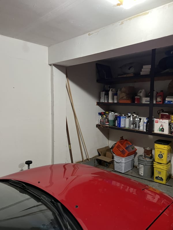

I was just down in the garage looking at what they did. Of particular concern is the location where they cut into the double joist that supports the top of stair stringers (see photo). That’s not going to be an easy repair.
Question: If they do a full 2x10 sister and have to notch the ends to get the joist in, why is that necessarily bad? The ends of the joists are in shear, right? Would a 1/16” or 1/8” notch really have that big of an impact?
Here’s a better photo of the stairwell and the joist support walls:
That's one of those pesky wood issues. Yes, it's in shear...but due to the grain orientation and lack of strength, you can end up with significant splitting issues where it's notched. If the notch aligns with a particularly wide and/or weak grain or the notch is over cut, the new joist can split along that notch. Code allows it, but I've seen code allowable bearing notches fail before.
The long screws I mentioned in my repair suggestion above are there to prevent this kind of failure.
In the grand scheme of things it's probably not going to be the end of the world, and as long as you adequately fasten the new to the existing, the existing will take the reaction and prevent the other one from splitting. So perhaps I made a mountain of a mole hill on this one...sorry...habit!
