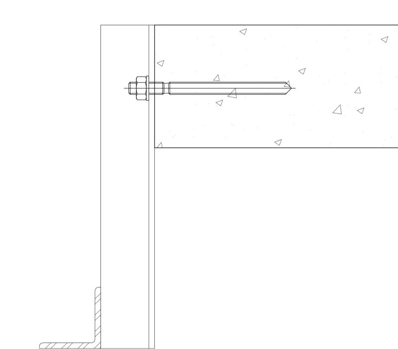

I am trying to figure out if the 3/8" plate can handle the moment and deflection from the weight of the brick on the angle that is welded to the plate. I do not know how to approach this.
The plate and bolts are spaced at 16", I already have factored the spacing into the loading from the brick.
 https://files.engineering.com/getfile.aspx?folder=61386d9a-4e1b-42b6-96e2-36da69f66034&file=Plate_Moment.pdf
The plate will try to bend to the right, below the slab. Deflection might be an issue.

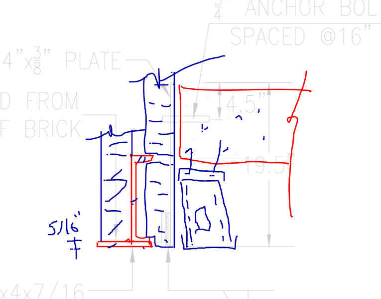

If you need 7/16 angle, then the plate should be 7/16, unless the 7/16 is for deflection... moment diminished from attachment at the angle to the anchor at the top. Your anchorage looks fairly massive with 3/4" @ 16. can you safely attach to the backing? are you going into masonry? You might want to look at adhesive anchors and slightly smaller diameter.

The most important dim'n is missing ... the distance of the load from the plate.
and "0.6K" is IMHO a bad way to write 600 lbs ... I first thought you meant 0.6kg.
Actually, scrap that last sketch. I didn't notice that the angle hangs lower than the slab soffit.
Sorry, the distance of the load to the plate is about 7 inches
I second that deflection may be an issue with a 3/8" plate.
If you don't have software, maybe find a formula for a propped cantilever beam with a moment on the end.
More important than deflection is rotation, but perhaps they are both important. It is a matter of simple statics, but the detail is pretty bad. If you need a 7/16" leg 16" long to carry 16" of brick, why on earth would you use a 3/8" plate, 4" long to carry the same load, with an even greater eccentricity?

Maybe something like... I should have added that 600 lbs is not a massive load... small compared to those usually dealt with. You could use hanger angles every 3 or 4' and use 1/2 anchors? My favourites Hilti HAS E55 and 200 Hilti Hit-Hy adhesive. [pipe]
The vertical member is an angle, correct? If it is that is something along the lines of what I am thinking of

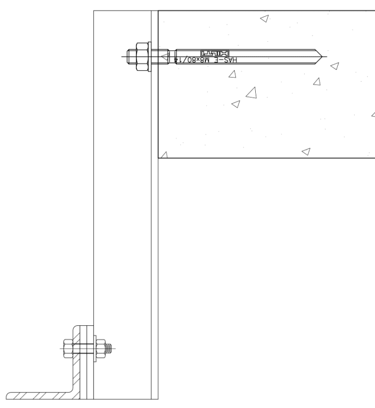

Another, imperfect option. It's a difficult situation that is usually heavily impacted by building envelope / thermal break concerns. And, from a building envelope perspective, most things push in the direction of loose lintels.
Yup Just updated my comment.
This has some nice mechanical advantages but thermal & constructability issues of its own.
If thermal is a problem, I'd add a small plate to the angle and use Fabreeka separator with bolts... That how you get a real thermal break... often do it for exterior pipe racks connected through an existing building.(Added sketch)

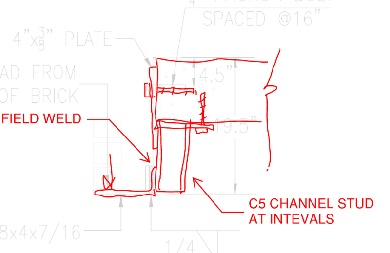

As a steel detailer, I have come up with this solution, without changing the original design, will it work for you?
Thanks in advance!!
