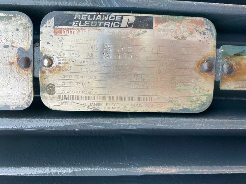

We have an inline pump with a 150HP/3 phase 460V, 165A nameplate vertical motor, Delta Start, Delta Run (6 leads). The pump and motor were out of service for over a year and recently serviced and moved to a new installation at a different facility. The new installation is a similar application in that it is being used for the transfer of #6oil between two bulk storage tanks. We are using an Allen Bradley SMC Flex Soft Start. We have the start and run leads wired in parallel. The motor starts and comes up to speed but is drawing about 215Amps when running ruinning at its normal operating point (2000gpm @ 200ft head). When we choke down on flow the current drops but to about 190A but can never get it to the 165A. The motor is a RELIANCE Motor from 1994. I obtained the factory information from the nameplate serial number. The factory cut sheet states a 208V motor. I just noticed that the current nameplate was originally stamped for 208V but then 'XX' out and re-stamped for 460V. Could this voltage conversion/rewinding be the cause of the issue?

The manf. wiring diagram shows (2) deltas 1,2,3 and 7,8,9. where only 1,2,3 for start then 1-7, 2-8, 3-9 for run.
The question I have is, exactly what pattern did the rewinder rewind to? Was it the LV pattern or the HV pattern when they converted it to 460V? You only mention the external connections you would use, which is fine, but how are 4, 5 and 6 connected inside of the motor?
I dont know what the current was uncoupled as we received the call from the electrician who stated that it ran fine uncoupled but drew high current when coupled and flowing product. We have a gate valve on the discharge and when first started and up to run speed the motor drew about 260amps with about a 60psig delta so we "choked down" on the gate valve to get the 90psi delta and the amps dropped. The more we "choked on the gate" the amps dropped but never to the rated current. We also never deadheaded the motor. We are actually gonna drain and do a no load test next week. Based on our run time and tank levels we were able to obtain a flow rate which matched the pump curve head. There are neither 4,5,6 external nor internal connections for this motor. The manf. wiring diagram shows two deltas (1,2,3) and (7,8,9). 1,2,3 are identified as start and 1-7, 2-8, 3-9 identified as run. There is no history on how the motor was rewound only that the factory states its 208V and the nameplate has been changed and the last installation it operated at 460v. What actually takes place when converting a 208V motor to 460? Wouldnt the original 208v winding have more/larger copper?
