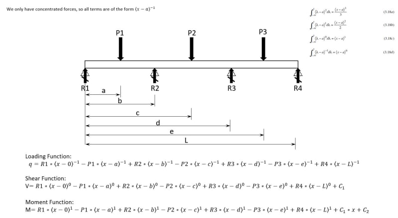

Use Macaulay's method i.e. singularity functions / discontinuity functions.
It is the most robust method for solving statically indeterminate beams by hand.
Everything being discussed will wash out in the loading function of Macaulay's method. You need to know the rules of integration though.

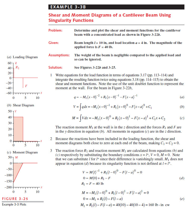

Actually, if you are just interested in finding the reactions, and not the shear and moment diagram, you wouldn't have to go through all the integration. Here is an example from Norton. Your's would be more complicated, but you can get the idea/form:

I agree that that is a method, but to show an example of a determinate structure doesn't show how to apply it to an indeterminate one
Ok, it's pretty general setting up the loading function whether the beam is determinate or not. It should be something like this:
If you apply boundary conditions at x = 0- and x = L+, that should give enough equations to solve, and C1 and C2 should be zero since the reactions are included in the loading function.
You might also have to keep integrating to get the slope or deflection and apply the BCs to those equations as well.
Here is an example:
