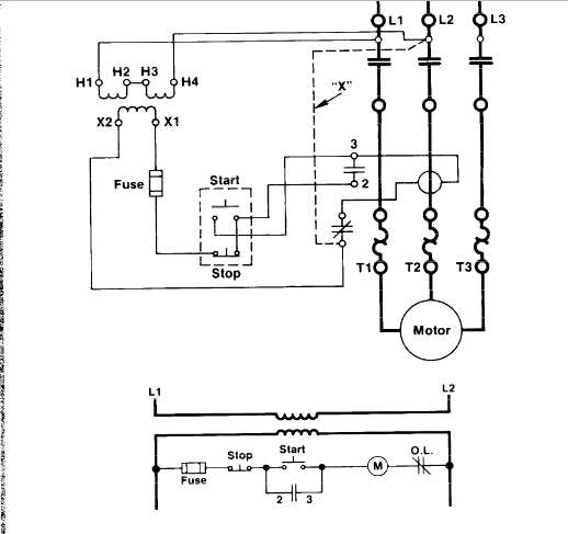

My understanding is this circuit causes delay of motor off by 1 second. I do not understand why the CR required and why the timer relay alone cannot be usedbe combined here?

1. There are numerous learned advice on the circuitry, some misinterpretation and without knowing the intention. This is caused by the WRONG symbol been used on the TDR N.O. (3) (5) contact and without reading the development diagram.
" it is a N.O. contact which closes instantly when energized, but delay open (after 1s as shown on the dwg), when de-energized"
2. There are other flaws/short comings as pointed out by learned readers.
a) e.g. To Stop the motor, the Stop N.C. pb MUST be pressed open for > 1s. Propose addition of (latching-in) e-stop etc..
b) The OL's N.C. contact (95) (96) shown between coil M and line X2 is Wrong. This is switching on the grounded Neutral line, a violation of IEC/IEEE/NEC/CSA document. It shall be wired ahead of coil M.
c) Line Terminal 1 is shown Fused but Line X2 shall be grounded (not shown on the dwg).
Che Kuan Yau (Singapore)
Despite your excellent technical knowledge, it is obvious that you have no actual North American field experience.
You are also misinterpreting North American Codes and Standards.
Are you seriously suggesting that every magnetic motor starter in North America for over eighty years is wrong as it comes from the factory?

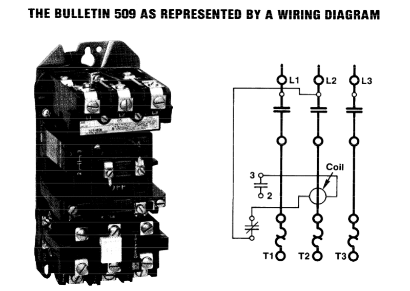

Waross said:
Shown here is typical factory pre-wiring of a typical magnetic motor starter in North America.
This is an approved assembly, and the NEC rules for field wiring do not apply.
The Allen-Bradley brand as well as all other manufactures in North America publish standard wiring diagrams.
This is a sample.
All brands publish and pre-wire to identical diagrams.
Across the line control:

Well, I see some of the responses here are about as messed-up as that circuit is.
With a simple timer like that, you need a way to separate the timer action from a power loss or stop button press, which means CR is required.

1. I stand by on my words, that switching placed on the grounded neutral is technically WRONG.
2. No matter what has been the practice in the US for the past 50+ years. This mistake also appeared in the NEC 1999 Handbook page 485 Fig 430.17 .
A mistake is a mistake, no matter how long the mistake has been in practice.
3. A similar case, the use of two heater overload for three phase motor had been the practice for the past 60+ years ! It is only recently that the mistake been corrected that three heaters shall be used on the three ungrounded conductors.

There are small din rail mounted UPSs, that could be used for one bucket. I am not advocating for this method to be applied universally across the site, which as why I added "on an as needed basis". I also included a qualifier, "If upgrading the control power is not feasible". I would assume that the power is not this unreliable across the entire site or else I would assume that there are more expensive issues. I would advocate that unless the site determines, it is cost effective to provide a more reliable source of control power, the only option would be more localized, i.e. per plant, per MCC room, per MCC section, per bucket. I would consider any of these options depending on the pervasiveness of the power problem and the budget the facility or the OP has to work with.
Other than providing reliable control power, the NEMA example that waross provided, I would think to be most appropriate with the addition/retention of a CR if DCS or other control, monitoring interface is typical throughout the site. I would not advocate for the TDR in this usage. For motor protection and reliability, I would advocate for the addition of a suitable power monitor interlocked with the stop circuit, with the parameters set for use specific application.
Recently in Canada was about 50 years ago.
Your insistence that millions of starters and millions of electricians and engineers are wrong, in several countries, does much to detract from your credibility when your suggestions are correct.
The wire that you are concerned with runs from the starter coil to the attached overload relay.
It is often only a few inches long.
The wire of interest is typically not long enough for any part of the wire to reach any grounded surface.

Agreed; che12345, I have often found value in your posts. Please don't "shoot yourself in the foot" by inflating theory over practicality to such an extent; if you persist in this, you only do yourself a major disservice.
