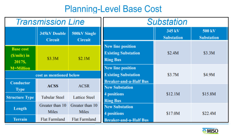

For areas where 345kv is sufficient for both capacity and distance, is there any advantage to using a 500kv bulk power network? Such as having higher Kv equipment but at a lower current rating, ie lines, cables, 550kv 2000amp 40ka breakers vs 362kv 3000amp 63ka breakers.
I know that is very broad question- like asking what ocean life or bacteria might evolve into billions of years from now- but any standing specifics or general facts that come to mind such as cost difference? I'm all ears.

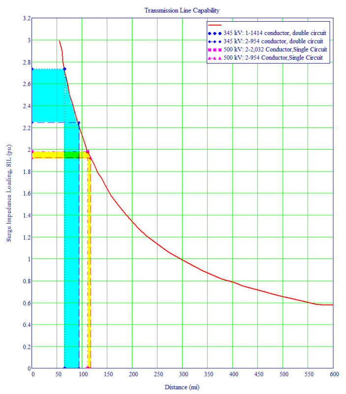

In general, a short transmission line up to 50 mi with a transfer capability rating of ~1,700 MW in single circuit operated at 500 kV is more cost effective than a double circuit line rated for 345 kV. See below for additional information.
Cuky2000, Excellent perspective and to be honest this what I was looking for. Not to say the other comparisons aren't just as good.

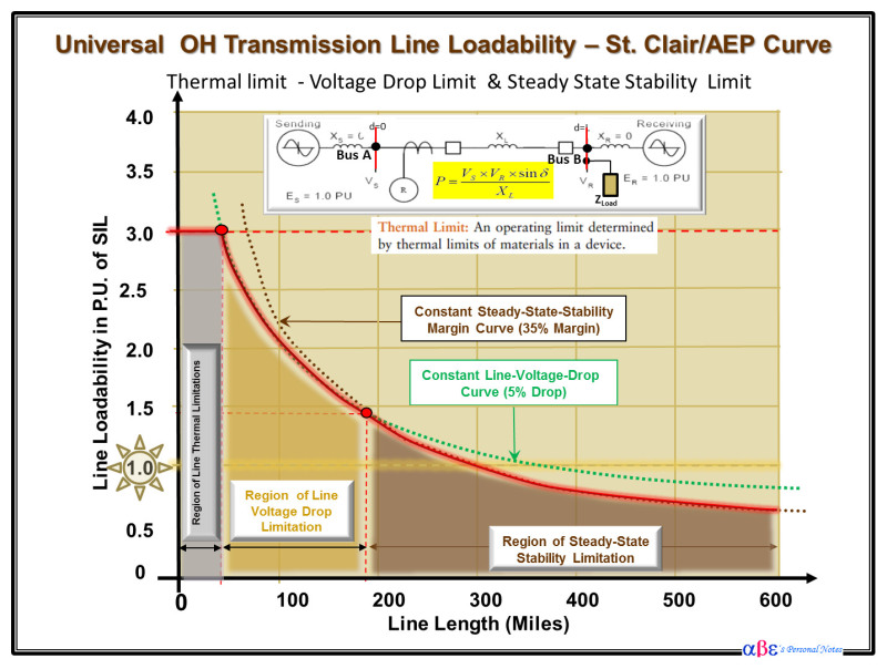

Mbrooke, we are moving out off the original question, to explore any advantage of using 500 kV considering that a 345 kV is sufficient for both capacity and distance. The intention of the loadability is to show that for the given ampacity and voltage rating the 345 kV require double circuit and single circuit for a 500 kV. So the graph was useful to show that 500 kV could be lower cost in many instance.
For a new T. Line in a network, many other factors need to be considered such as system reliability and contingency. For example, if a sudden fault in one circuit how this will impact the system stability a readjustment of the power flow. I do not see any data in the post to make any comment.
Still the curve provide other inside info for the postulated cases:
[li] The 345 kV double circuit operate closer to the thermal rating of the OH conductor[/li]
[li] The 500 kV line operate in the voltage drop region [/li]
[li] For fault in one circuit, the 345 kV could use larger bundle conductor and the 500 kV will require another redundant circuit[/li]
[li] Line series compensation for short line do not provide significant advantage for 345 kV or 500 kV[/li]
[li] To prevent or mitigate overload in parallel lines, FACTS or other systems are options to increase reliability but add capital cost [/li]

I would disagree- double vs single circuit (as well as CCT) is very relevant to this conversation. If contingency planning and system operators must view a double circuit line as a single circuit, then the 500kv single circuit option becomes a lot more attractive, even cheaper as presented in another post.
Thank you again for the graph- this helps a ton and its exactly what I had in mind.
