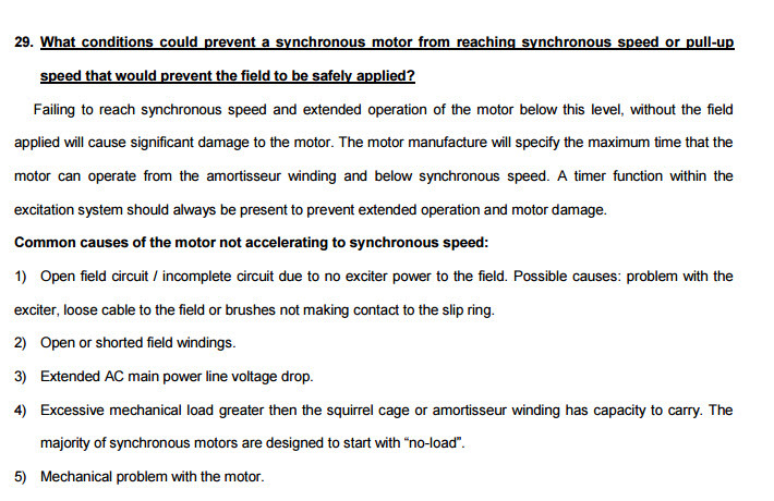

Mkees,
Check out item # 29 in the attached link.

I know that information is copied, but there is almost no way you can attempt to start the motor with the field open and not cause damage to the field. The rotor will produce many 1000's of volts when open and this will cause the field to flash over at the weakest insulation spot.
