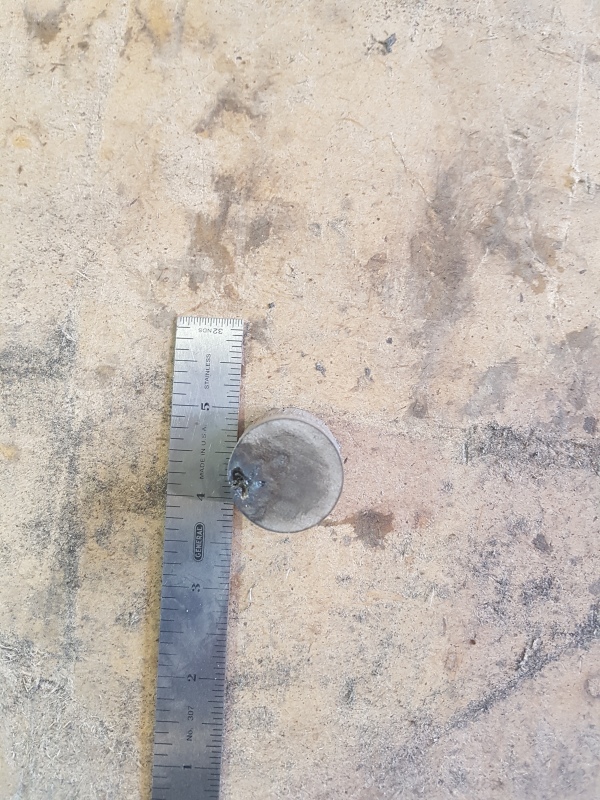

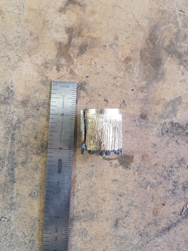

here's some pics of 1" stainless on my 4kw
now I want to cut some 1" [deejay] ..... I bet u can clean those cuts up a bit with your gas pressure and driving focus down a little deeper I think anywho [machinegun]
