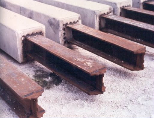

Shakta - We (bridge contractor) never drove composite piles, except for precast, prestressed concrete with stubby HP points, like this photo from the web:
For composite piles with the dimensions you are considering, the only thing that stands out is that the joint is the weakest place. Any lateral force applied to the pile during driving puts the pile at risk. To compensate for this, make sure that pile alignment (either plumb or specified batter) is maintained during the driving process... no "tugging" on the pile to pull it back into alignment as driving progresses.
Of course driving properties will change when the concrete portions enters the soil, but this should not cause a problem... just something to be noted.
