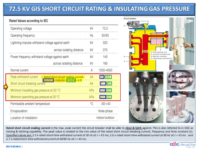

4) Can you explain this a bit more? These 13.8kv breakers appear to be 5-cycle breakers and are overdutied as well so may need replacement. How does a faster clearing time here impact fault duty on the 69kV bus if both interrupting and momentary are of concern? Significant SC contribution is attributed to the 13.8 kV, 83 MW generators. A faster circuit breaker and protective device with potential synchronous control help to reduce the thermal and dielectric stresses on the GIS. Two physical requirements (regimes) are involved: Thermal & Dielectric Regime. The forces on the GIS busses are usually not the limiting factor. However, only the GIS manufacturer can check if the busses, vessel, disks, and other components have an opportunity to be uprated for higher SC. The publication below provides generic data regarding the typical SC, close & latch, peak current rating and minimum insulated gas pressure recommended.
Thermal Regime: The hot arc channel has to be cooled down to a temperature low enough that it ceases to be electrically conducting.
Dielectric regime: After the arc extinction, the insulating medium between the contacts must withstand the rapidly-increasing recovery voltage. This recovery voltage has a transient component (transient recovery voltage, TRV) caused by the system when the current is interrupted. If either of these two requirements is not met, the current will continue to flow for another half cycle, until the next current zero is reached. It is quite normal for a circuit breaker to interrupt the short-circuit current at the second or even third current zero after contact separation

Thanks for the information that is helpful. It looks like with faster clearing times the GIS could potentially withstand a larger fault current (momentary and interrupting)based on current construction or the potential for manufacturer to beef up components.
