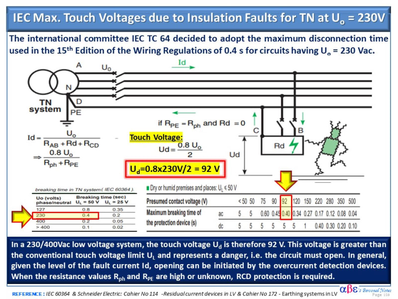

I'm really confused by this engineering article. How can the maximum touch voltage be 92 volts on a 230 volt system when in theory it ought to be 115 volts or higher?
In case of a system voltage of 230 Vac phase to neutral, the reason why a time of 0,4 seconds is specified is because 0,4 seconds is the maximum time a person can be subject to 92 Vac. That is the normative touching voltage in a TN system operating at 230 / 400 Vac.

Mbrooke,
We should no be confused between the application of system voltages with determining the maximum tolerable safety voltage for equipment grounding (earthing) system.
The ANSI and IEC have different approaches to address the safety requirement and clearing time associate with protective devices.
For a low voltage system 230/400 V, the max. touch voltage allows by IEC Standard associated with different grounding (earthing) system are as follow:
[ul]
[li][highlight #FCE94F]92 V[/highlight] for a TN (if RPE = Rph and Rd = 0 )[/li]
[li]115 V for TT (if Ra=Rb).[/li]
[/ul]​
See below for more details with the rationale for the published max. touch voltage of [highlight #FCE94F]≤ 92 V[/highlight]

Waross,
Notice that there is confusing information on the original post mentioning 230 V and 115V in the first sentence.
However, the quote and link clearly refer to a max. touch voltage 92 V per IEC Std for a system voltage of 230/400 Vac.
[ul]
[li]The voltage phase-to-phase =400Volts[/li]
[li]Nominal phase-to-ground 400/1.73 ~ 230V.[/li]
[/ul]​
Cuky, our original poster was unfamiliar with European 230/400 Volt three phase systems and took it to be a center tapped 115/230 Volt system.
I didn't realize that until I saw your post.
Then it became clear that the 92 Volts was on a 230 Volt to ground system.

Hi 7anoter4,
Thanks for sharing with us the excerpt from the British Standard BS EN 50522, Earthing of power installations exceeding 1kV a.c. Please help us out to verify if this standard is applicable to LV 230/400V TN system and if compatible with the IEC Std 60364-4-41: PROTECTION AGAINST ELECTRIC SHOCK.
The link provided in the original post by Mbrooke contains a graph (see below) derived from the IEC Std 60364-4-41 indicating that 92Volts is the maximum tolerable touch voltage for a TN system 230/400V in dry conditions.
Fill free to estimate from the curve below the max. clearing time for 230V and verify if is satisfactory close to ~0.13 sec.

Ok- but why does the voltage dip to 92 volts and not 115 volts?
I have not a IEC 60346-4-41 copy with me but I have a copy of Schneider Electric - Electrical installation guide 2008
and the explanation in chapter 6.2 Protection against indirect contact [for TN system] it seems to me logical.
First the body current curve AC4.1 [the left side limit of AC4.1 area ] used, so it is lower than what EN-50522 took [the right side limit-so higher].
Second, if the phase conductor impedance equals PE conductor impedance the voltage between fault location and ground will be 230/2=115 V. If the voltage drop will be 20% then
this voltage will be 92 V.
From chpt.3 Protection against indirect contact. Specified maximum disconnection time:
“The IEC 60364-4-41 specifies the maximum operating time of protective devices used in TN system for the protection against indirect contact:
- For all final circuits with a rated current not exceeding 32 A, the maximum
disconnecting time will not exceed the values indicated in Figure F13.
- For all other circuits, the maximum disconnecting time is fixed to 5s. This limit enables discrimination between protective devices installed on distribution circuits”
Fig.13 for 120<Uo<230 t=0.4 sec.
In my opinion, nevertheless the minimum voltage to ground it could be 0.8*115=92 V if the PE connection is damaged and interrupted it could be total Uo=230 V so the disconnecting time remains 0.4 sec.
