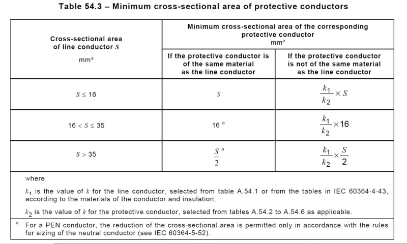

I'm really confused by this engineering article. How can the maximum touch voltage be 92 volts on a 230 volt system when in theory it ought to be 115 volts or higher?
In case of a system voltage of 230 Vac phase to neutral, the reason why a time of 0,4 seconds is specified is because 0,4 seconds is the maximum time a person can be subject to 92 Vac. That is the normative touching voltage in a TN system operating at 230 / 400 Vac.

The 20% phase-to-neutral voltage drop is reflected In the formula below calculating the prospective max.touch voltage as follow:
Ud = 0.80xUo/2 = 0.80x230V/2= 92V. [Assuming a resistance of the ground loop: Rph=RPE; Rph/(Rph+RPE)=1/2
Where; Rph= resistance of the phase conductor & RPE Resistance of the neutral Uo=nominal phase-to-ground voltage=230Vac
The protective device (RCCB=residual-current circuit breaker or GFCI) shall sense and remove the fault current on he neutral Within 0.4sec required by the IEC Std.

@Waross- I think I just might be able to agree with your assessment/interpretation of the situation. I'm doing some detective work on just where/how the IEC obtained that 0.8 multiplier but I'm coming up cold. Even the IEC veterans are having a hard time finding an inference.
Personally, I see no reason why a long enough run from a very large main switchboard won't cause 115 volts (or even higher) potential relative to remote earth. Look into the adiabatic method... the EGC can get really skinny.

Your statement is true as long as there is no current over the bonding conductors.
When there is current over a conductor there will be an IR voltage drop and the bonded equipment will rise above ground potential by that amount.
