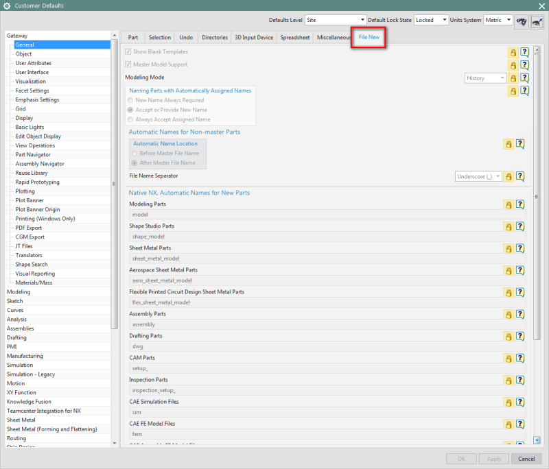

You can find this in the customer defaults for Native files.
If you are working in Managed environment (Teamcenter), then you, unfortunately, cannot change it that easily. This is depending on the relation type used for the UGPart.
