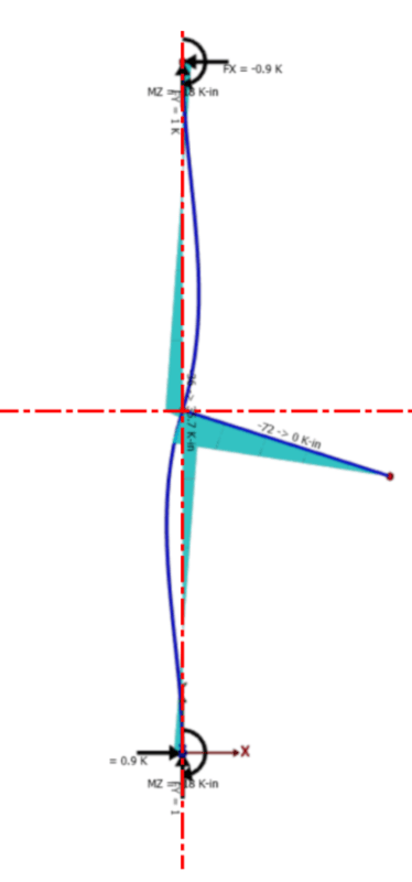

Take this model as an example:
Here is a 10ft tall W10X12, pinned top and bottom, with a 3ft long HSS3.5x0.3 cantilever. The live load on the end of the cantilever is 2K.
Graphing a diagram of the moment shows two points of maximum moment, with an offset between the two:
Zoomed in view of the moment in kips & inches. Interesting how the point of zero moment doesn't hover the 60in mark, as that's the true center of the load. Also, I would have expected the offset to occur over a length of at least 3 inches. Either way, this somewhat confirms my understanding that the load applied to this beam-column is actually two transverse loads with a moment arm between them.

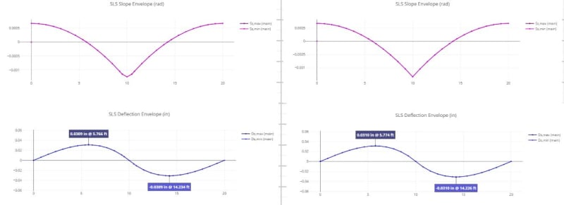

Another interesting thing is the relationship between the deflected shape and the location of maximum moments.
Beams loaded with this concentrated moment would take a deflected shape as shown below. According to the AISC table, the location of maximum moment is at the applied load, while in theory this is the location of inflection along the beam column.

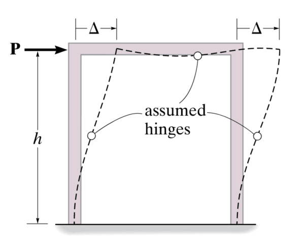

This is confirmed by a portal frame analysis. The beam columns for a fixed portal frame experiences S-type deflection and the inflection point of the member is assumed to have zero moment.

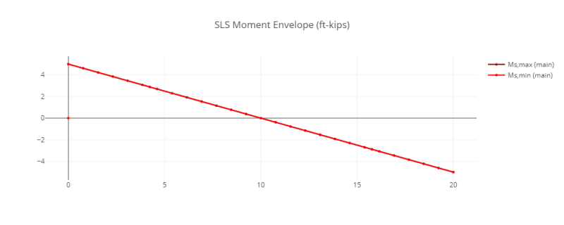

1. I think your graphs are set in your software to linearly draw moment lines from discreet points. If you have the ability to increase the number of discreet points along the member I think your graph would approach that of the AISC diagram.
2. While the point of inflection is at the point of moment application, note that the CURVATURE of the member is maximum at that point as well. Thus the maximum moment occurs at that midpoint.
Also the tables are not giving an approximation, it's the theoretical solution.
If you considered a free body of your column with the beam forces as loads, then you may well end up with something as shown for the moment. But the result you're seeing is probably due to what JAE has noted as typically analysis software will be using discrete line elements connected on centerlines to represent the members. Take a look at the shear and I'd imagine you won't see the panel shear effect on the shear diagram.

See attached (pg. 2). Are you talking about a portal frame with fixed bases and an applied lateral load? Then yes, your points of inflection = 0 moment in that case.
If you're talking about a portal frame with pinned bases and two floors under gravity load (the upper frame on pg 2 of my attachment), then I would say your inflection point at the first floor would be the location of the max moment in the columns, not 0 moment. Granted, it's a moment reversal from + to -, but I don't know that I would call that 0 moment.
In the pure analytical case no the inflection point does not have zero moment it is the location of change of sign of the moment. In reality the moment is likely the result of some form of force couple so there would be a 0 moment location.

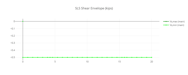

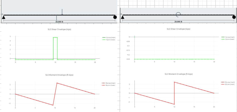

Close Point Load Couple vs True Concentrated Moment:
(notice the large shear delta in the coupled point load case)
I see what you're saying. I cannot get the model to display the moment exactly like AISC, but I was able to increase the number of points along the line and see it's headed that way.

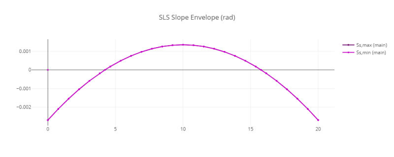

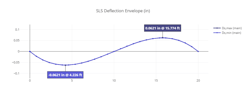

My apologies, I don't really see what you're saying. Is there another way you can explain it? From my point of view, the curvature is largest at approximately 1ft above and below the application of the moment.
Here is the deflected shape with a straight line run through the centerline of the column.

No, the inflection point is not assumed to have zero moment.
I see what you mean from your images and I agree that the point of moment application is the location of maximum moment and the point of inflection.
I've done both free body diagrams by hand and got the same results as you've shown, I'm not debating that.
I was just comparing it to this scenarios from lateral loads on a portal frame which have zero moment at the location of inflection.
I had it ingrained that points of inflection equal zero moment.

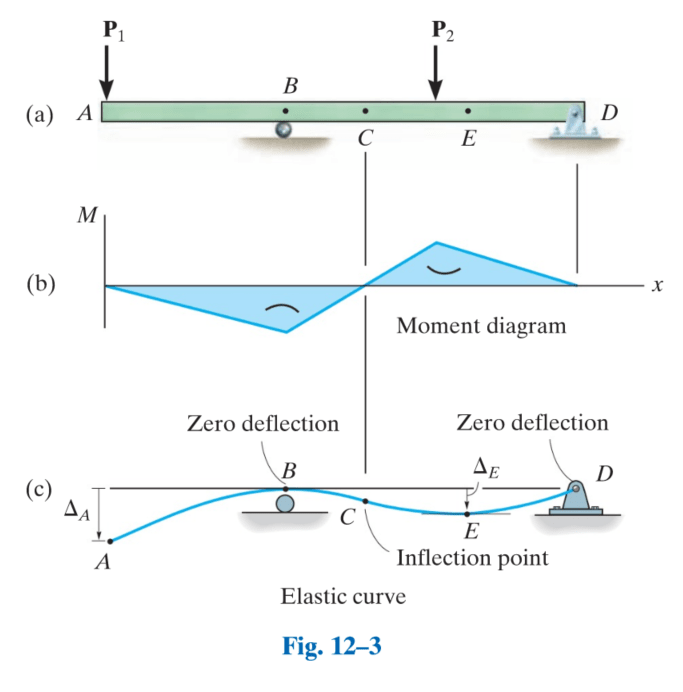

Another scenario:

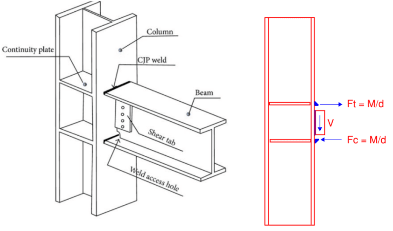

My original question was about where this scenario actually occurs. Isn't part of the reason we have continuity plates to ensure that moment enters the beam without local buckling failure. Through the continuity plates, we establish the idealized single point load moment as others have mentioned.
In terms of where it would actually occur, I think your quick 3D model is a good representation. Something like a bracket coming off a column to support a facade element or structural beam.
For your second example points B and E are technically also inflection points of the deflection curve but moment is not 0 at those locations.
A portal frame analysis works on the assumption that the column has no loading along it's length and moments at each end generating double curvature and 0 moment at column mid-height:
those continuity webs are there so the couple (Ft, Fc) forces are not applied directly to the flange of the supporting beam (as out-of-plane loads) but are instead sheared into the web of the supporting beam.
Does this mean that we can agree there is a force couple that introduces the load into the beam. But for the sake of our analysis programs, that forces couple is taken as a single point load moment and thus we fall back to the AISC beam diagram?

"Does this mean that we can agree there is a force couple that introduces the load into the beam. But for the sake of our analysis programs, that forces couple is taken as a single point load moment and thus we fall back to the AISC beam diagram?" ...
the couple is important only to the local structure, you need to provide an adequate loadpath. Once you're away from the immediate area of the joint, the beam behaves as though it was loaded with a theoretical (and impossible) point moment. For example, I'd happily model the beams in your example as 1D BEAM elements, and to a local hand calc and a local build drawings to account for the real world.
