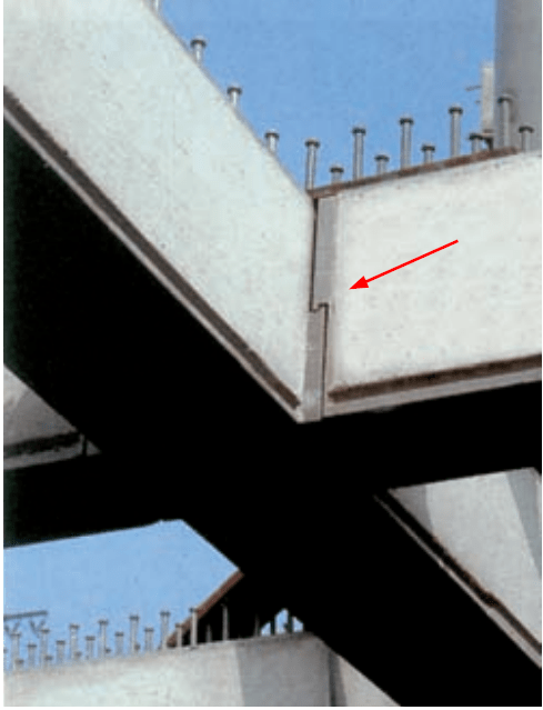

PS: I always supposed that end plates must have the erection gaps, but then once got to the German Museum of Technology in Berlin. Almost all steel girders/beams/joists out there are connected through end plates (most likely hinged). Haven't noticed any large gaps in-between. Might be they are just too small. Will try to recover some of my photos, but they looked some kind like that
I've never done a connection like that; it looks too complicated and costly, and difficult to develop a moment if required. If it's a 'snug' fit (not tight) between columns, the shims allow for easier placement. Occasionally (more often than the other) end up with steel being framed into existing steel... and shims are the only way (cost effective way). I typically spec 1/2" max shims, and often spec slip critical. It doesn't affect tensile load for moment, and there is often a surplus in shear capacity.
