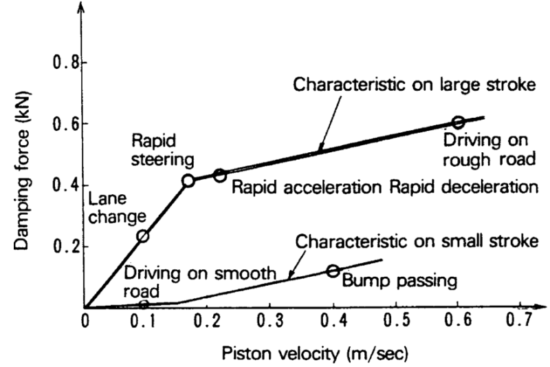

This is curious:
The foundational work seems to be from Fukushima, Hidaka and Iwata (1983) Optimum characteristics of automotive shock absorbers under various driving conditions and road surfaces:
However, their digression point is closer to 0.15m/s, about 6in/sec. This is substantially higher than the current 2-3in/sec recommendations.
A full 3d damper characteristic makes you realise how poor the f vs v graph is at representing real damper behavior. Even worse is when you measure the force in the shock and the velocity as it drives over the road. A proper dynamic model of a shock absorber needs something like 40 terms.

However, at what velocity should I digress off, considering a motion ratio of 0.63?
I visualized it at Dennis Grant's 3in/sec. I balanced overdamping at 4in/sec with underdamping at 10in/sec:
Fukushima's 6in/sec. Overdamping is terminal:
