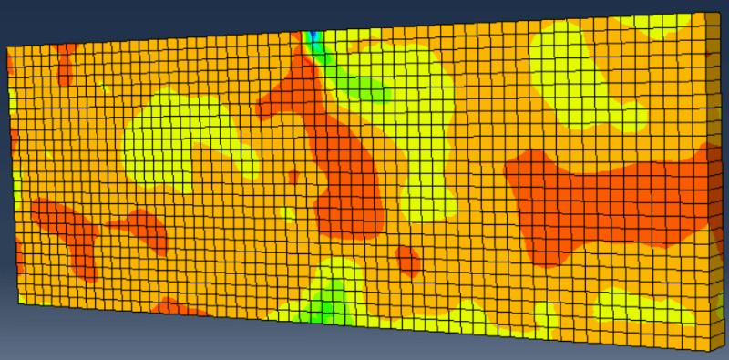

I am currently modelling a plate with 3D elements (just 1 element thru thickness):
I have applied a displacement BC on the right surface, as well as restraining moments. I have fixed the left face as shown in the image above.
I am looking to determine a stress vs strain plot, as per this thread. similar to what you get from testing
However, I'm not sure how I would go about this problem on my side, due to the moment constraints on the RHS surface.
Therefore, I have currently output the nodal force at a location on the RH face with time and multiplied it with the total number of nodes on the RH face (to get the total nodal force as a close approximation). I then divide this total nodal force by the area to get the stress on the RH face. I have then output displacement at that node with a function of time, and can convert this to strain via post processing.
What do you think of this method? The reaction force and Ux displacement is constant on the RH surface due to the applied BC.
Any suggestions welcome.

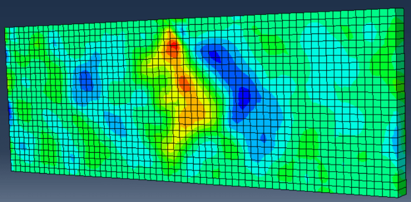

My S22 stress and E22 strain (loading direction is y) is shown below in order. Are these the ones I should be using.

The plate is now loaded in Y direction but how is it oriented and constrained ? Can you show a picture like in the first post (with boundary conditions and coordinate system). I’m asking because stress and strain distribution looks rather unusual and it’s important for determining the location to measure stress and strain.
To sum the reaction forces you can use XY Data from Field Output, pick the nodes that are constrained and then operate on XY Data using sum operator.
Oh sorry, I gave the wrong image at the top, but for the contour plots below, the x and y directions are flipped (wrt to the first post).
It is a discontinous fibre filled composite, hence the weird stress field. This is why I'm having the difficulty in choosing the correct point to obtain a stress strain plot (I know post processing is required).
Essentially, the plate above is the flange of the image in this link: , akin to a flange of an IBeam which is then being pulled to failure. At the middle of the plate, there is fibre flowing into the flange, so I guess I have to choose an element/elements away from the centre of the plate (due to the web) but not to close to the applied displacement BC.
In that case I would measure force and displacement and then convert it to stress and strain. Basically a virtual version of what is done in physical testing. You can measure total reaction force in the loading direction as I described previously (sum of RF2 for all constrained nodes).
I think I understand the method, but to confirm, I should do this (extract Force and displacement) for all nodes on the RHS face.
Why can't use use S22 and E22 that ABAQUS outputs? Is it because you essentially lose information.
Reaction force can only be obtained from the constrained face. Displacement can be measured at any representative point. In this case measuring stress and strain directly will be difficult due to nonuniform distribution of these variables. Hence the use of overall force and displacement for the sample.
