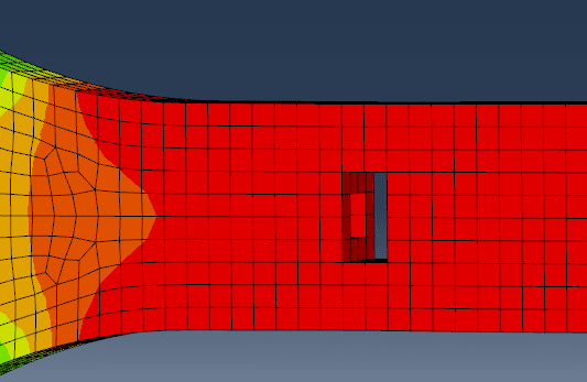

Yes, the elements has been deleted. I am simulating a tensile test of a specimen with Abaqus Standard. But when it has broken into 2 pieces, the solver cannot continue the next increment.
Convergence difficulties might occur in Abaqus/Standard once the sample is broken into two pieces. Is it necessary for you to continue the analysis after it happens ? If it’s static analysis you can try with automatic stabilization in step settings. This may help.
Even when a few elements have been deleted like this picture, the solver cannot continue. The plastic property of material is:

I’ve seen a similar issue in tensile test simulation with built-in damage criterion. Adding automatic stabilization in step settings helped the analysis go further, up to the point where fracture propagated through the entire cross-section. This I think that this is the best option in your case as well. Just make sure that it doesn’t affect the results significantly.

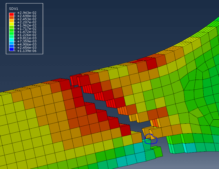

Oh yes, thank you so much. I've got this after adding the keyword. You can see in picture focusing on blue mark, 2 brick elements now sharing one node so they will be highly distorted in next increment.
