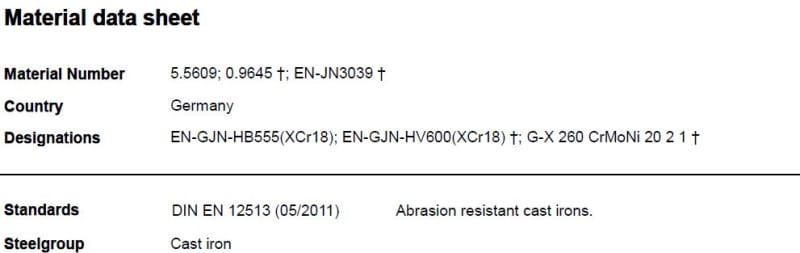

The Pump Vendor has offered an abrassion ressistant cast iron with a minimum harness of 51 HC. Material designation 5.5609 (DIN 12513)

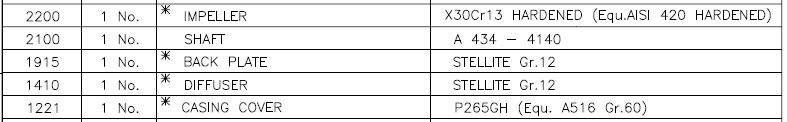

We have used Stellite Gr.12 (for casing)HRC 30 and X30 CR13 Hardened (for the impeller) for the previous pumps but still the hardness was not enough and the casing and impeller wears our quite fast.
Now Vendor is proposing (Material Number : 5.5609; 0.9645 †; EN-JN3039 † ) DIN EN 12513 (05/2011) Abrasion Standards resistant cast irons. HRC 51

My question is : can cast iron casings and impeller be used for hydrocarbon service?
I would say they can. I can't see any issue with impurities and cast iron components are often used with hydrocarbons
Is there any chances of spark during operation if the pumped stream has hard solid particles?
No. A "spark" needs air / oxygen to become a "spark" which is really just very small particles or hot iron / steel oxidising rapidly in air.
If you're wearing out stellite and hardened 13chrome then I suspect abrastion "resistant" cast iron won't be much better. Where did your process group come up with a hardness of 38-42??

These pumps were originally purchased with A487-CA6NM + HVOF Tungsten Carbide (Impeller) & A350 - LF2 + HVOF Tungten Carbide :
But it weared off quickly so the Vendor proposed for an upgrade of the impeller and diffuser material to a harder material (which was the stellite and the hardened 13crome :
But it is still wearing off. Now we are totally replacing the pumps and we went to another Vendor and asked for a more harder material than stellite and hardened 13chrome. The Vendor then offered abrasion resistant cast irons :
I really am not sure if these will be any better than the other materials already tried. The pumps will come by this year and will start operation by early next year.

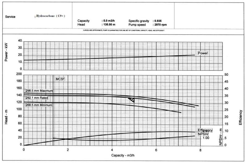

You need to look at the hydraulics as well.
What is the pump speed, is it running at or near to its BEP.
A few photos never go amiss.
Artisi has the right track here.
You need a lower speed pump, and you have to make sure that it is running at BEP.
Both of the systems that you have tried are proven and should offer very good performance.
Their failure indicates to me that you have other hydraulic issues.

The pumps are running near BEP.
Running at 2970 RPM
However, i do not have a picture of the wear parts of the pump.
The hydraulics of the wearing pumps for reference :
I would think your excessive wear is related to the pump speed, unfortunately for the flow/head combination it is unlikely a suitable pump operating anywhere its BEP at 4 pole 50 Hz is possible,
Might be worth investigating a diaphram pump or a mono style pump, not my field of expertise but there are others here with experience in this area - hopefully you can get some input.
