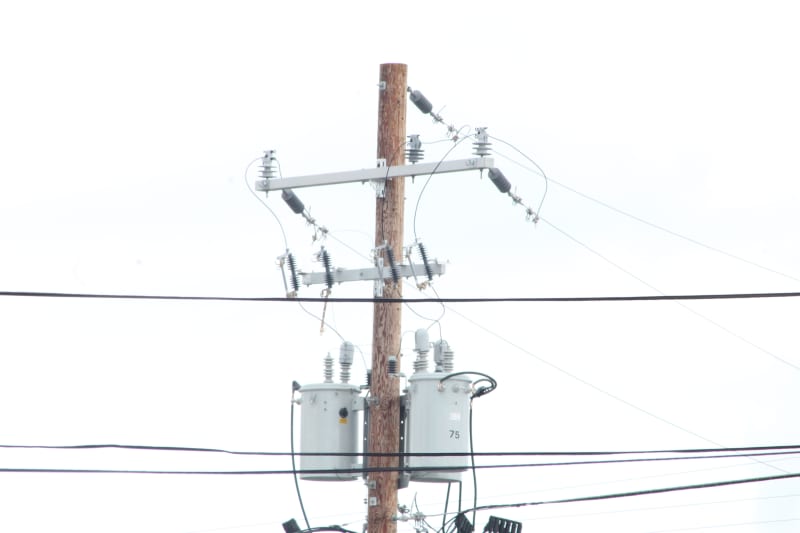

Definitely. I went out and took pictures in the area because there is some unique stuff out there. They have many 12kV:12kV isolation transformers to convert delta to wye for underground feeds. They also have some redneck versions with two distribution transformers back to back to do the same.
waross said:
Grounded with circulating currents?
Floating with higher voltage switching transients?
Fused? One partial solution was to install a fused cutout in the wye point connection. When local maintenance was done, the fuse would be installed in the wye point cutout to avoid switching transients. When all three phases were energized, the neutral fuse would be removed to avoid circulating currents and the wye point would be left floating.
I saw such a bank some years ago. I went back a few years later to take a picture but it was gone.
240 delta service is definitely a challenge to deal with. In the days of 5kV primary, there were no issues. At 15kV there are some, but in the 25kV or 35kV class there are severe problems without good solutions.
I've never seen a bank like that. I have 3 utilities around me, one is 12.5kV and dipping their toes into 34.5kV. One is 12.5kV and 24.9kV. The third is 20.8kV. I know the two with the present higher voltage have done both floating wye point and grounded wye point depending on when the bank was put in. When they ground the bank, you see cutouts dropping out all the time. This is a bank only months old. The fuse is still sitting open two months later. Coincidentally, the open fuse is on the "lighting" phase so that transformer is acting as the ballancer on an open delta bank.
Thats not a fuse, but a solid copper link. I can tell because of the color, shape and holes in it. Its closed when the bank is being energized one fuse at a time to prevent ferroresonance and opened thereafter to prevent future fuse blowing during faults out on the line.
Unless the customer has a large amount of 3 phase motors the best option for a legacy delta customer is a grounded wye open delta bank. ie, 2 167kva (or over) pigs for that bank.

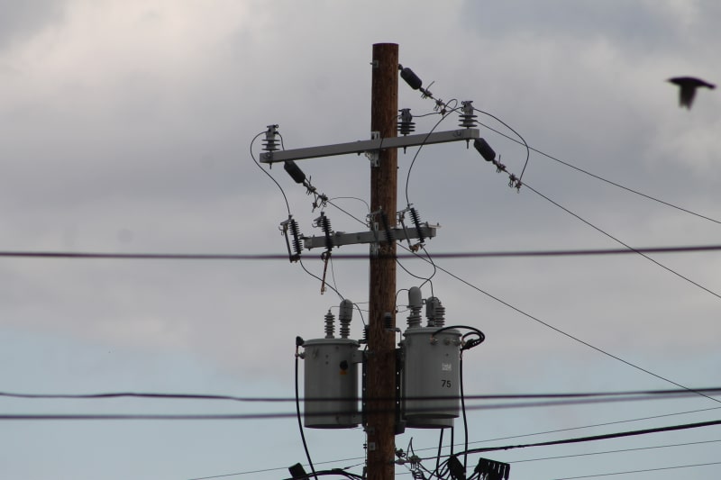

Well I'll be - you're right!
I ran through several exposure settings because my camera was struggling with the overcast sky background. With a different exposure setting, you can clearly see the wiring and that there are three fused cut-outs.
This bank was added when they added air conditioning to the town's city hall. The existing service remains, so all this powers is an AC system, presumably almost all motor loads. No explanation on why it would be delta instead of ground wye - ground wye for brand new service.

Brand new service? That would surprise me. I thought that is what replaced the previous bank you showed which would make sense. Its possible the old system was ungrounded or high leg all for the city hall and this is just feeding the old. That or someone screamed it has to be delta which would be worthless in a new installation. Its a guess. I know of a thread where an EE demanded a 120 volt only drop because he thought it would save money on that extra wire...
