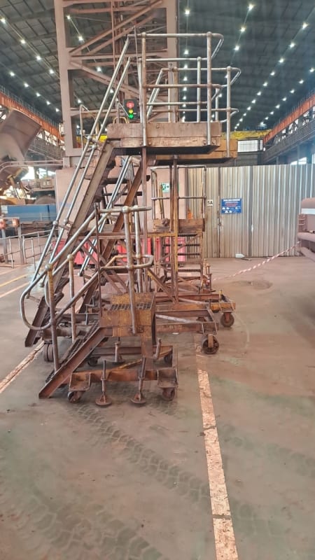

I have been given a project to implement an access control system for artisans using step ladders with wheels.
Now my question is how will I go to work in having the ladders inspected, issued to specific individuals, what controls can I put in place to ensure I can keep track of who is using what ladder even when I am not at work?
Any suggestions or ideas will be much appreciated

Can you post a picture of the "wheeled ladders" of concern ?

With access-control I find the first critical question/criteria to be - Who are you trying to prevent from accessing the ladders, and where? Trying to prevent the public from accessing ladders in a city park is vastly different than preventing access in a commercial storefront, as-is preventing access from certain employees inside of a factory setting. The first may require placing the ladder inside of a locked building. The last could be accomplished simply with a sign stating "unauthorized use subject to discipline or termination."
I just assumed this was like the ladders they use at the big-box stores, google image search for "rolling ladder" pulls up a ton of those.

My idea was to keep all of them in a designated area, lock the area and the individual ladders, issue the keys to individuals and record the info.
The idea is to know who is using the ladder and who used it, to control and identify who is damaging the ladders and keep them accountable.
I don't want it to be a lengthy process to get and bri g back the ladder as we are working production and time is valuable.

You have two choices. Your security guard asks people why they have ladders, or you supply ladders to authorized people. Either way, your security guard is trained and authorized to make decisions. Those ladders in your photo do not look like anything I would keep in the trunk of my Honda Fit.

Sadly we don't have a security gaurd overseeing the ladders or anything. Yes the laddera are in a terrible condition, thus we want to implement control, because they are very expensive, Biggest ladder approx R350000.
If you say there needs extra equipment to prevent damages, what do you mean?
All I know is that these ladders are very heavy and do not move easily? Also wanted to look into bigger wheels to make moving easier?
JMO but it appears that you have a problem with respect caused by poor maintenance, not access. The ladders in the pic dont appear to have seen fresh paint in years. If management doesnt care that equipment looks like rusty garbage then I wouldn't expect employees to treat it otherwise. Painting is like sweeping, anybody with time to lean/bs has time to push a brush or broom. Give staff a steady supply of paint and cleaning products, encourage them to improve their areas during slow/down time, give them a pat on the back when they do, and you'd be surprised how pride keeps your facilities nice and equipment functional.
JMO but I'd buy paint, not locks.
You could pursue the typical Safety Program Administration approach explained in OSHA documents. Perhaps your designated Safety Person at the plant has done this already.
[ul]
[li]Identify the hazard, possible causes, consequences, and possible solutions using a rigorous Job Hazard Analysis[/li]
[li]Implement methods to mitigate the hazard to protect workers using the Hierarchy of Safety Controls:[/li]
[li]Elimination (get rid of the hazard completely if feasible)[/li]
[li]Substitution (use something else that is less hazardous)[/li]
[li]Engineering Controls (purpose-designed and built mitigations...typically guards and shields)[/li]
[li]Administrative Controls (training, certification, standard op instructions, work instructions)[/li]
[li]Personal Protective Equipment PPE (last resort solution to mitigate any hazard)[/li]​
[li]Deploy & Implement new policy[/li]
[li]Enforcement[/li]
[/ul]
I once had a similar situation. We did not want to restrict the workers from using ladders to get their jobs done with unnecessary irritations or complications. But we wanted safe behavior to address previous injuries. We got it by Administrative Controls: training and SOPs. And we had the luxury of engaged management at the company, so there was very active Managerial Enforcement of SOPs and Policy.
