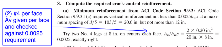

When you are determining the distributed reinforcement in a deep concrete beam per ACI 318-19 Section 9.9.3.1, are you supposed to have 0.0025*bw*s of reinforcement area on each face or total between both faces?
I have a concrete textbook, Reinforced Concrete: Mechanics and Design by James K. Wight, that appears to show this is required per face according to the example snipped below.

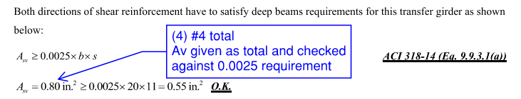

I also found this other design example online that is from structurpoint.org that appears to show the reinforcement requirement can be totaled up among both faces.
-This interpretation is not true . The area of distributed vertical reinforcement (perpendicular to the longitudinal axis of the beam ) Av,min =0.0025bws, covers both faces . The nominal area of no.4 reinf . is 0.2 in2 and No. 4 legs at 8 in. on centers each face. Av/(bw*s) =2 * 0.20 in.2/20 in. * 8 in. =0.0025.
-The other design example that you have found online is also correct the calculation is the total reinf. ( vertical and horizontal at both faces ) .
