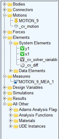

i run the Co-Simulation properly in adams View and it is a really simple transaction ... only a sphere that its acceleration or its velocity is the input and defined by a constant in simulink and the displacement defined as the output as measures then state variables.
problem is that when I attach the constant block to the adams_sys block in Simulink and get a run , the co-simulation runs perfectly but there are no interactions and the matlab input does not take its effect on the adams block or simulation , nor does it appear in the results in the postprocessing .

Try in the settings adams_sys (red block "msc software") change the animation mode from "batch" to "interactive". So you’ll see visually that the model does not respond to signals from Matlab. If this is true, then the connection is incorrectly created or input / output is incorrectly spelled out. Send a screenshot of the Controls Plant block and the text of the line that you prescribe for variables in Aview.

first of all when I insert measures in my state variables this error pops up :
ERROR: The function expression indicated contains at least one error.
ERROR: Description : The identifier '._MSC_TRUCK_DOUBLE_WISHBONE_SUSPENSION.MEA_ANGLE_20' was found instead of one of the following:
ERROR: integer, real, constant, TIME, function call,
ERROR: IF, left parenthesis or Adams View variable.
ERROR:
ERROR: Function text : "[[._msc_truck_double_wishbone_suspension.MEA_ANGLE_20]]"
ERROR: (The element at or immediately after the error is
ERROR: enclosed in double brackets '[[' and ']]'.)
ERROR:
i define my measure as a joint and and angle and define it for a state variable in adams view interface ....
this thing happens with all of the models when i know for a fact that this doesn't happne in another pc ????

( Initially, like you, either there was an error with the mention of the firewall, or the simulation was still going on, but the output parameters did not react to the input values. After careful study, I noticed that the file "abs_brake_controls", to which the m-file subsequently refers, does not occur immediately after the ACAR test (I suppose, therefore, there is no correlation). Therefore, try to do the following:
1. Open the assembly with variables and first create Controls_Plant. IMPORTANT: the name will vary depending on the test. If this is inhibition, then “name_brake”, if the movement in ISO-03888 is “name_ilc”. However, if you don’t know what postfix will be (the last letter after “_”), you can run one simulation.
2. After the Controls_Plant is created and the m-file appears, perform the required ACAR test, and as a prefix (the first word before “_”), specify the same word that was in the place of “name” during the export.
3. Re-export the already created Controls_Plant.
My problem was solved in this way. I hope that helps you too.
Regarding the interactive / batch mode, adm-files only work with batch. This I knew, but forgot, sorry. Visualization will be possible due to res-files and postprocessor.
