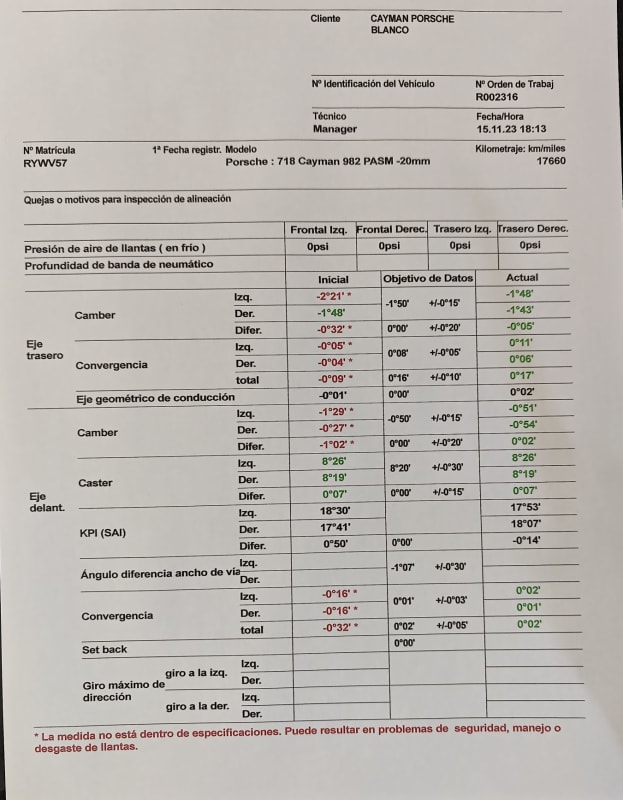

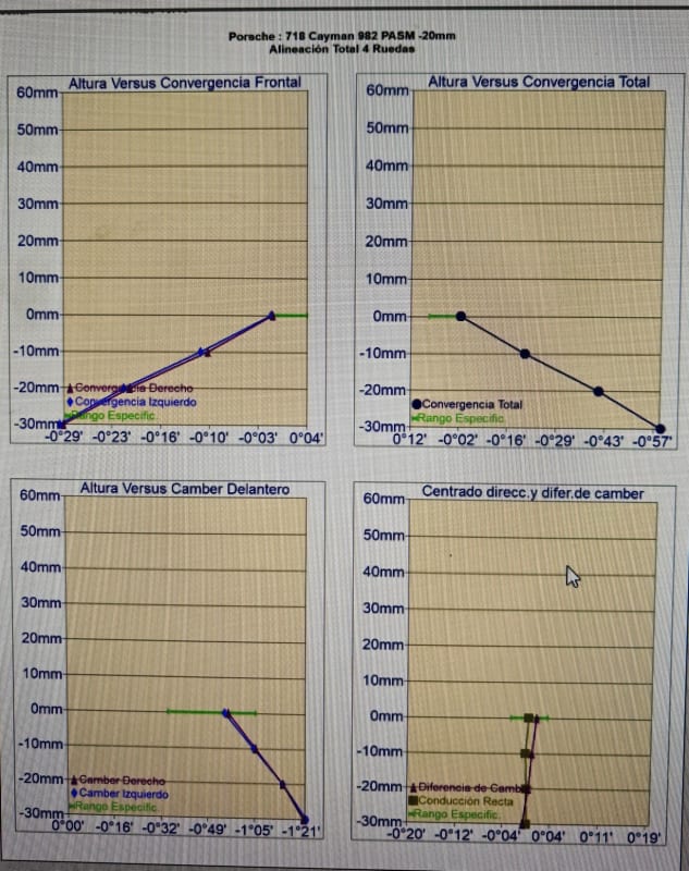

Hello All
I had my car aligned using the Hunter alignment values specified for the -20mm Porsche Cayman 718, which are included in the Hunter machine's database. I've attached the graph showing new reading, as well as the charts comparing the alignment before and after the procedure. Any comments or insights would be greatly appreciated.

So your camber was out of whack on one side both front and rear (bad), and is now OK, and you had static toe-out before on both front and rear (bad), and now have slight toe-in both front and rear, which should be good. There's still a lot of bump-steer by the numbers, but it's now very close to the same left to right.
Repeat your drive-over-a-bump test, and report back with findings. I have a funny feeling that the car will behave now.
It's on the high side of just about every one of the many, many, many sports cars I have K&C data for. If so, 1 or more of your front tires ought to start showing shoulder wear.
Static toe-out is a cheap Ackermann steering patch, also bad for adding understeer, reduces max lat, and makes the steering gain nonlinear thruout the range of 'sporty' driving. Especially on tires as oversized as come with this make/model.

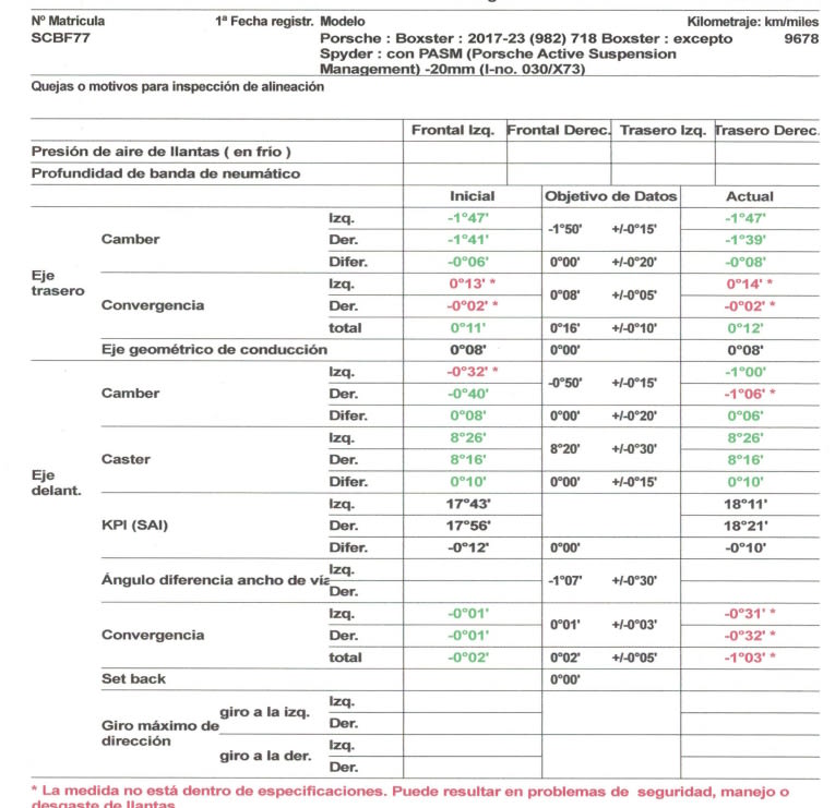

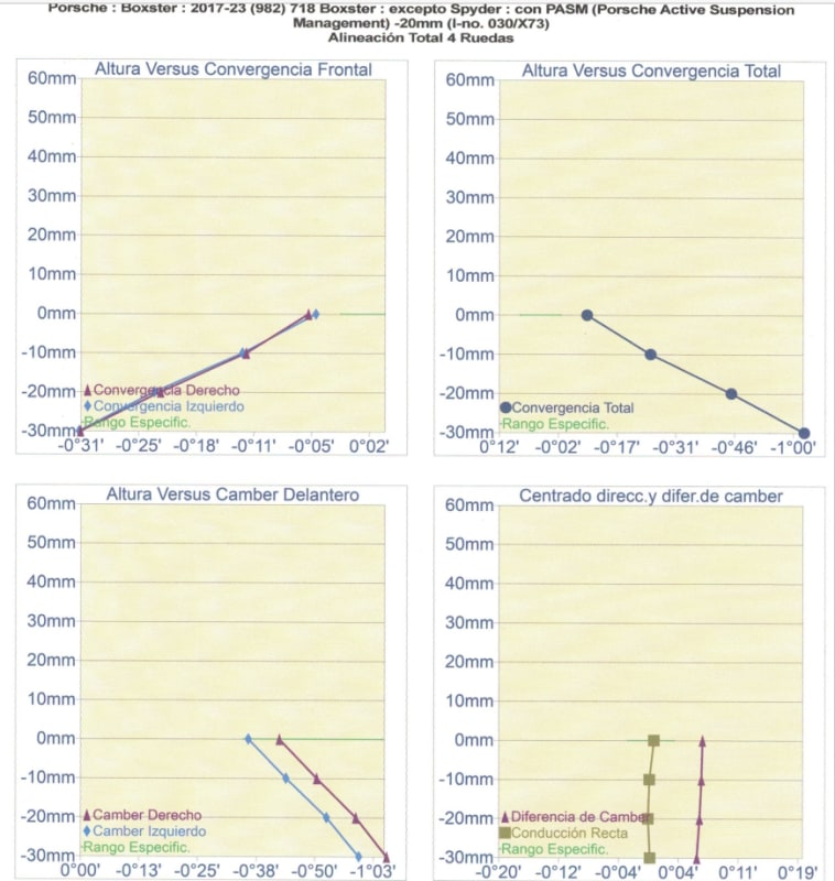

We took two cars to the hunter machine: my car, equipped with a retrofitted 20mm drop Porsche suspension, and another identical car with the same suspension, but factory-installed. Essentially, we had two identical cars, both with the same suspension setup; one was installed by a Porsche dealer, while the other came with it as a stock setup. The car was slightly out of alignment, but you can still check the toe movement during compression of the suspension on a factory stock suspension.
How do you see it compared to my car ?
Here is the graph from the other car:
Are very similar bumpsteer values for both cars,

At this point I'd say the bump-steer that you have in the car, is what Porsche designed it to have.

According by wikipedia, Taycan have different weight distribution, can be reason? Interesting asymmetric values,but is really under 2Dg/m difference too much?

BTW: you can easily figure out what the ride steer would be with a 20 mm change in static ride height. It's probably quite a lot. BTW2: the car I showed you data for has ROLL STEER values of 8% exactly on both front wheels. So, same symmetric roll steer but asymmetric ride steer tells me exactly how carefully your OEM build was done. Guess the cause !!
Yes, Cayman (original post) is not Taycan (that link) but same manufacturer so maybe similar design philosophy? Internet says Cayman has 55% rear weight distribution, Taycan is very close to even split. That kinda suggests the Cayman needing more understeer from its geometry. The way I'm reading it is that Cayman (original post) has something like double the bump-steer of Taycan, but what's also striking is the substantial difference left-to-right in the Taycan.
A 20mm one-wheel compression bump in the original-post Cayman makes a 0.18 degree toe-out steer angle change on that wheel. If it's a true one-wheel bump then the other wheel stays put and the steering mechanism splits the difference roughly speaking, so 0.09 degrees of steer-angle change. If the steering ratio is 15:1 then the steering wheel would, ideal-scenario, jiggle by 1.4 degrees. That's not much. Reality is probably less than that because presumably the front instant-center is probably above ground level which means that wheel would simultaneously have its contact patch move outward from the vehicle a smidge which kinda-sorta agrees with that wheel toeing out a smidge ... keep in mind also that the rear is probably toeing in a smidge when it goes over that same bump one wheelbase-length later ... still, all these effects are looking pretty small.
