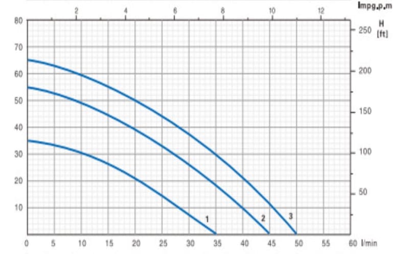

Hello,
My pump is rated for 5-30 LPM. However, the system I'm using only requires a flow of 5 LPM. What are the ways to make sure my flow remains at 5 LPM knowing that my pump is a plug and play? No switches.
A control valve of some sort (globe or needle).
But what type of pump? That would work for centrifugal, but PD you need to control the speed.

If you get lucky a fixed orifice plate might be used, but valves are infinetly variable.
Thanks, Little Incy, Appreciated it. If my pump was centrifugal. It would have been equipped with a way to reduce flow, right? What would have been the option then? VFD?
Your pump IS centrifugal.
If your pump was positive Displacement (PD) then to vary flow you vary RPM or stroke length if you can.
See the thread next to yours in the pump forum for the same question but this time the OP has a PD pump.

Please bear with me. How can you tell the difference? It's my understanding that a centrifugal pump has an impeller, my untrained eyes thought that any pump with a circular large shape on it is centrifugal.
Yeah I think that is what they call a "peripheral" pump. Sort of positive displacement, so amps will go up with a restriction. You will either need to vary the speed or pump into a pressure tank and just draw 5LPM as needed. A centrifugal pump would be much better and a simple valve would give you 5LPM.
Indeed it seems it is a peripheral pump - never seen one before really and I suppose it's a mixture of a centrifugal pump and a PD.
The pump curve is quite interesting as it slopes down at a near constant angle so the head at low flow is high but at max flow is quite low.
So yes it will use more power, or maybe the same power at lower flow, but you can still control it with a valve.
Yours is curve 1 on the below.
Without getting too involved with sourcing data that the OP should be supplying, it looks like a regenerative turbine pump, it follows the rules of a centrifugsl pump regrading speed change etc, Good for low flow, high head - fits well for flow / pressure between small centrifual and PD pumps.
