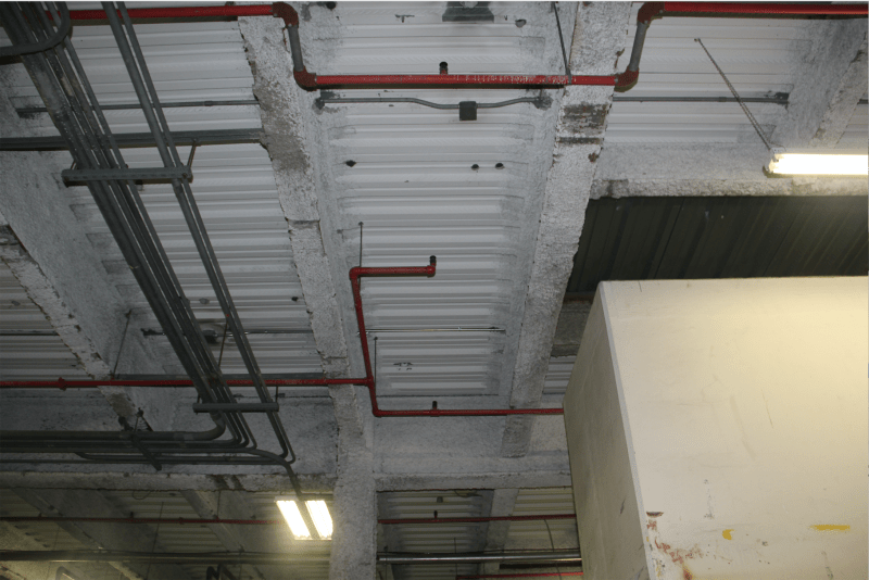

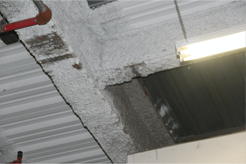

Hello,
I'm analyzing a 120,000sf factory floor, 2VLI 8" total thickness, that appears to be built for WWIII for a new piece of machinery. It was constructed as an addition with W24x55s @ 6'-3" o.c. x 30' w/ W33 Girders spanning 25'. The steel is fireproofed and from historic Google Satellite images, it wasn't there in '94, but appeared in '02, so a maximum age of 27. No useful data points from the owner, auditor, or municipality. Are there any clues that would indicate what grade of steel should be used in the analysis, either 50 ksi A992/A572 or 36 ksi A36 for a building of this age? Deflection typically governs, except in one instance at a since infilled floor opening where there was previously a gigantic concrete pylon.
My second question is, what is the likelihood that the floor was designed as composite and would smaller members used to frame openings also be composite (running in same direction)? Are there rules of thumb where you only design the main floor members as composite or is there a rule of thumb to assume it is not composite at all, since you wouldn't have the headed stud properties anyway? Thank you in advance for any input,

For your time period, you most likely have A36 steel. A992 did not come out until around 2000 and did not become the preferred material specification for W-Shapes until around the 2004 to 2005 timeframe. I agree with phamENG, if you need strengths greater than the minimums of A36, then have some coupon samples taken and tested.

Thanks @Spanky7, I found other posts here resembling your timeline - some saying earlier than '04/'05 and all stemming from Northridge (94) as @PhamENG indicated. I analyzed the typical bay for 250 psf LL as a benchmark and determined the typical beam fails with a non-composite A36 design and checks out at 50 ksi.
I had to figure it out for myself why composite construction should be ruled out for Industrial Buildings, so I analyzed composite sections and found they'd be smaller than the brute W24x55 if designed to capacity. But no sense in picking a smaller beam with less connection capacity and all the work of headed studs, so that's settled.
Since an A36 floor would only be good for 200 psf, which does not match up with conventional heavy industrial loading, it is my opinion there is a high probability that 50 ksi steel was used to get the 250 psf LL capacity, but I know that that isn't a guarantee and more work needs to be done.
