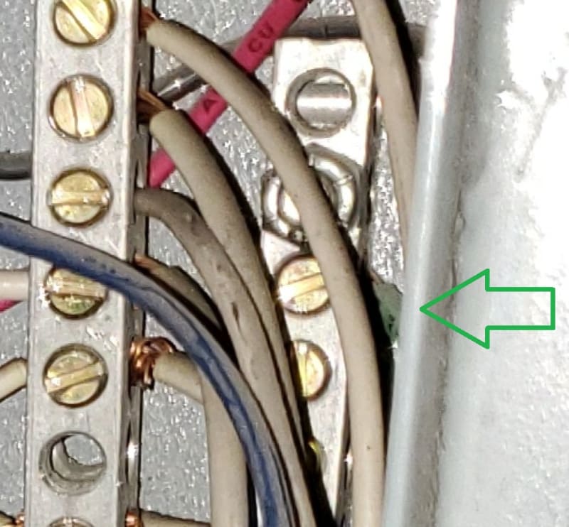

I don't see a single green wire (typically earth ground) in that enclosure.
-AK2DM
"It's the questions that drive us"
I think ground is running along the right hand wall of the box, and the camera angle is hiding one of the two screw terminal strips that are normally used for ground connections.

Analog, ohh you of little faith...
Anyone can see the well thought out grounding plan that's meticulously implemented.

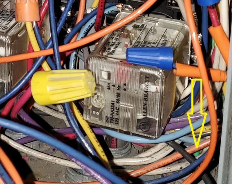

Further demonstration of the quality work!
Note even the detailed effort put forth as demonstrated by the tidy wire-nut application (left most).

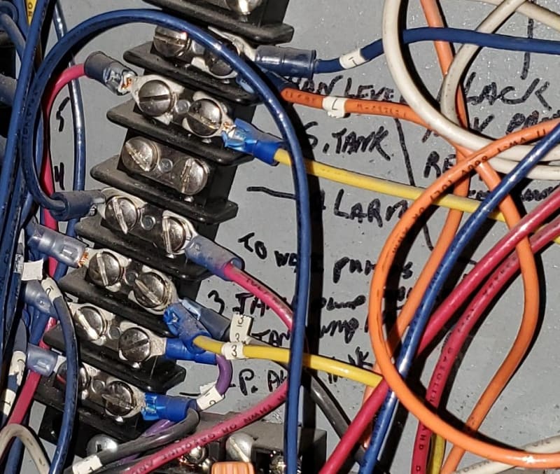

And, while you have me wound-up let me show you the workman-like documentation provided.

Wire tags and notes on the box, wow. They out did themselves.
Quite ingenious.
That's a very thoughtful effort at color coding using orange tape on the blue and red conductors in the middle photograph deserves honorable mention.
Compared to the inevitably missing comments files that one deals with with PLCs, the in-situ subpanel grafitti documentation in indelible marker has a certain, shall we say, appeal?
The whisker hanging out of the orange wire nut is undoubtedly labeled a 'test point' somewhere in the 'documentation'.

I like the fact that the connector marked "ALARM" have no wires connected (!)
The blue connector in the middle photo also appears to have the orange wire cut off?
