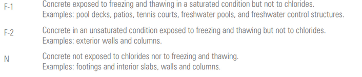

What do you all call out for air content in residential concrete? Specifically foundation walls and footings. I've been revamping my general notes and have seen other engineers specify no air, 5-6%, or not mention it at all. No air seems to be the most common.

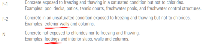

Based on the ACI I'm coming to the conclusion that footings and foundation walls should both be F1 at a minimum (maybe F2 for some foundation walls) and should have 5% air, although this feels a little conservative for the footings since they are at frost depth and the top of them probably won't see much freezing/thawing and/or water. Just curious if any of you have had pushback on this in the residential world.
For Canadians, this is all spelled out via our performance classes (cut sheet). Might be useful as a guide for you. Also, one thing that's often overlooked is the construction cycle. While some items may not require an air entraining agent due to limited freeze-thaw exposure, during service, quite often footings / slabs / walls and the like go through a construction cycle that has them exposed to the winter elements. In which case, an air entraining agent may be a good idea.

I generated this from the durability requirements in ACI 318 and 332. Be sure to check it for accuracy before you use it. I delete lines that don't apply to the project, and edit if needed for additional strength or other performance requirements.
Thanks pham. Why do you use 6% air for F1?
Because it's the 'standard' (note other responses, above), and I'd rather have more than less, even with larger aggregate sizes. If the plant doesn't have a mix design that will work and they want to justify lower air entrainment because they larger aggregate, they can submit an RFI.
