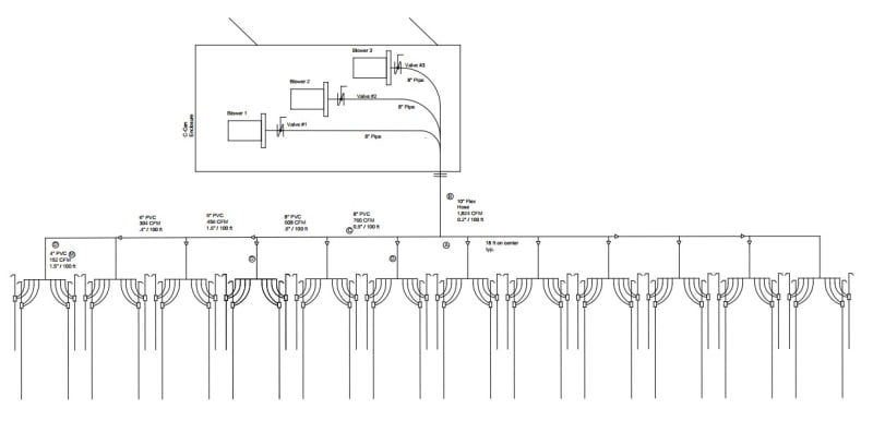

I am working on a project that feed air flow and pressure to Air Pumps to supply fresh water and air to fish in a Fish Farm.
I need to operate three Blowers (two operating at one time and alernate with the third)
My issue is when two blowers are operating at the same time one of the blowers will dead head, either due to the shear or air pressure in the pipe.
The System:
Operating pressure is 55 inWC and 800 CFM each Blower.
The air travels through a common pipe.
The Blowers are operating with a VFD and a common pressure Transducer.
I use 8" electric actuated valves on the discharge of each Blower.
Sequence of operation.
- Blower #1 and #2 operate Producing 800 CFM @ 55 inWC eac. The Valve for Blower #3 is closed.
- After a set time (1 week) Blower #1 will stop and Blower #3 will start. All three Blowers Close during the Transition and Valve #1 Closes while Valve #3 opens.
This is done to stop any of the air from travelling in reverse through the Blowers.
How can I get two Blowers to operate at the same time through a common pipe without one dominting the other?

You can't without some form of added control.
You can accomplish the needed control by synching motor RPM across the two blowers that are operating and allowing RPM to change according to pressure feedback, you can throttle blower flow prior to entry into the common duct, etc - there are multiple ways to skin the cat. But if all the blowers are 'blind' to what the others are doing, you won't have a lot of control.

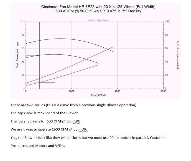

But what is the system flow and pressure and what does it look like in terms of air pressure versus flow?
What do your fan curves look like?

System flow is a total of 1600 CFM and pressure required is 55 inWC.
See attached Blower curve.
There is only one common Transducer the reads the pressure off the side of the pipe not the velocity pressure.
When both are operating the one Blower will operate at an elevated rpm to meet the required air pressure while the other will deadhead and the fan casing will get hot.

No curve attached.
Also do you have any other points on your system curve at say 800, 1200, 1600, 2000 at the least?

Well that explains everything.
Basically your blowers are far too big for the duty and you're operating them on the wrong side of the curve. As soon as you have one blower going then the next one cannot generate enough pressure to start flowing until it is running at a higher speed than the first one. But then as soon as it does start flowing the first one will get dead headed and so it goes on.
That manifold arrangement is truly dreadful and you should connect each blower into the main 10" header with its own connection
Now even with your 20hp limit it looks to me like one blower can just about do your duty. What happens when you run one blower flat out up to your stupidly sized 20hp motor? Now you might not make your 1600 acfm @ 55in WC, but it looks like you'll be pretty close to me. Or buy a couple of bigger motors. Even 25 hp would do it I think.
Here it is for everyone:
Here's the "P&ID"
Thank you

This is my other solution to this that may work.
See attached.
Do you see any major issues other than the header.
I have to fit this in a 20 ft Sea-Can with an office.
 https://files.engineering.com/getfile.aspx?folder=4e743d49-e04e-469c-bbc6-f77d03145e85&file=PID_2.pdf
I think that could work.
Your blowers are still too big but you would share the load that way.
Will one unit not do it though?
Yes one blower will work but this is a critical application.
So if a Blower or drive fail the system will still operate until it is repaired.

I feel like the others in this thread are saying the same thing, they just aren't saying it explicitly, so I will. Put simply:
Because your fans are so oversized for the application, running two fans all the time and balancing the demand between those fans is not possible. There is no controls solution that will yield the result you want.
Based on the size of your fans and where they operate on their curves, you have only two options to make this system work:
1) Replace the fans with units which are properly sized to provide for the air demand while running 2 fans in tandem
2) Revise the control scheme so that only 1 fan is running continuously, with double redundancy. You'll have to work out some wrinkles during changeover between fans, but if your process can handle a little bit of air flow fluctuation during changeover it's a survivable scenario.

The key part is that you are operating in the part of the curve where as flow increases the blower develops MORE pressure. This is quite strange and is why most people won't initially believe you.
The only way you could get this maybe to work is to run two blowers at a fixed speed more than min and then modulate the valve and control on flow on each blower.
Even then I suspect they will just fight each other all the time as they are simply far too big
