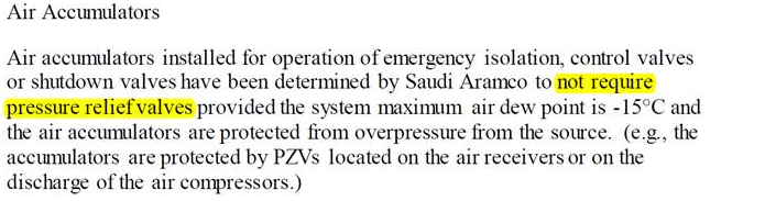

see attached procedure snap shot. I hope because of this reason, this safety valve not added in SAP for regular calibration. Normally all our PSVs are testing from 2 years to 5 years.
Refer to NB recommendation, we are thinking to add this psv in SAP for regular PM.
That's a pretty big air accumulator!
The point is that it looks like this vessel does have a PRV fitted, therefore yes, it should be tested.
Maybe it wasn't supposed to be there according to the extract above which I can understand and have seen before - basically it says that the upstream pressure source is already protected against overpressure so you don't need to double up.
