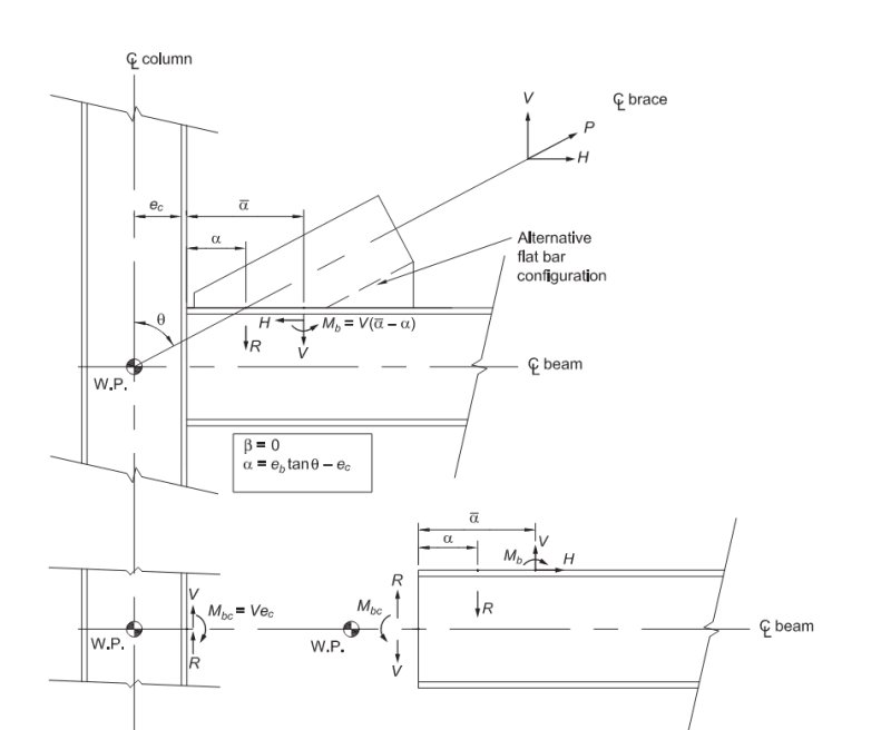

I have one follow-up question for special case 3. The example in the guide only uses M-induced force to check the beam web's local buckling & crippling. But does M (or Mb in the attached figure) alter the internal force in the beam? In other words, should the effect of M be superimposed with the gravity load moment diagram to derive the maximum moment within the beam? I think we should check it per equilibrium - but it is not reflected in the guide.

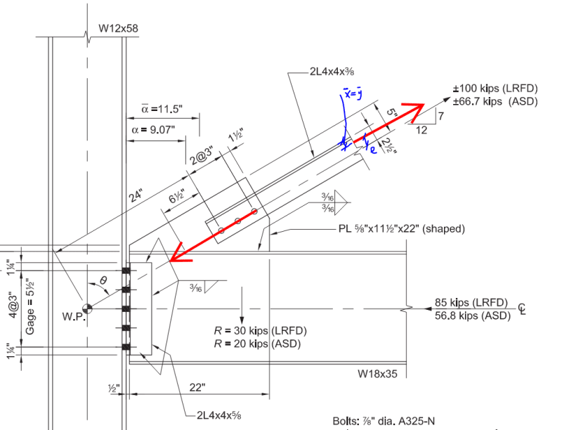

I also have one last question related to Example 5.4. The normal stress should be fairly uniform in the mid-length of the bracing. Hence, the force in the bracing should align with its cross-sectional centroid. On the other hand, the reaction at the bolts should align with the center of the bolt group. Therefore, an eccentricity exists—how should it be handled? I don't see the example acknowledging the eccentricity.
1) The example on DG29, pg 108, uses the additional moment as an "internal force" within the connection. It's probably OK to maintain your current global moment diagram, and only consider additional V & M effects within the connection design.
2) Standard practice under AISC is to ignore the eccentricity in angle braces, as long as they satisfy the stipulations of spec section E5.
