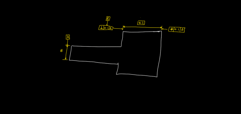

Here's another one that looks simple but is actually not.
I thought the best way to describe what I want to do was to sketch a wonky drawing of my requirement:
So Datum A is defined as the axis of the small diameter.
Datum B is then to be perpendicular to Datum A (if required).
Then I wish to define the 42 mm dimension, but the direction the dimension should be measured should be aligned with datum A and be the taken from the most distant points on the two surfaces.
I'm working in ISO so rule 1 isn't default but may be useful to apply?
Technically the 42 mm dimension only needs to apply between datum B and a circular boundary on the rightmost face, but let's walk before we run.
Any help would be greatly appreciated. Maybe it's all dead simple and I'm just too far down a rabbit hole to see the light of day. Here's to hoping hey.

In ISO you can apply Position to the surface, so make dimension 42 basic and apply Position 0.1 wrt B to your "rightmost face"

When I draw stuff like this, your datum face[ ]B is my primary datum, with the diameter datum[ ]A feature being my secondary. The diameter simply defines the centre point. Perpendicularity is to the flat face.
Your 42mm length is a feature of size, measurable with a micrometre. It can be rotated with respect to your orienting datum feature[ ]A. You need to control the perpendicularity of datum face[ ]B. Perhaps you could apply a positional tolerance with respect to datum features[ ]A and[ ]B.

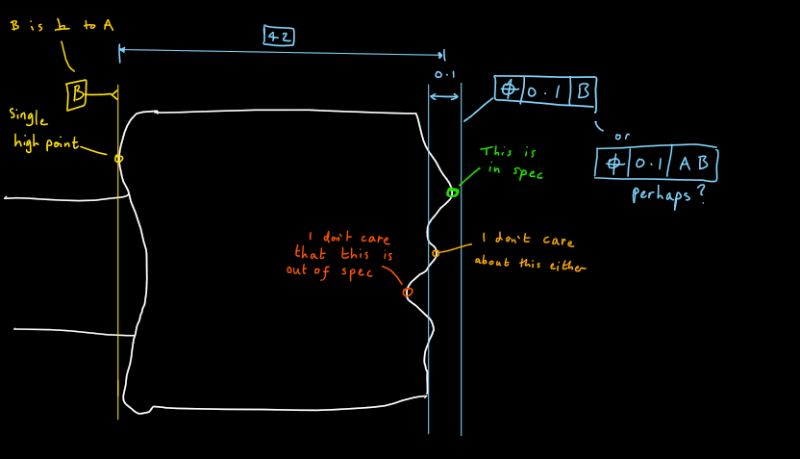

Thanks for the responses.
CheckerHater:
I did consider using Position like you say although I've found not many people interpret it correctly.
Further more I'm not sure it completely covers my situation. I only care about the highest point on the face - with the "height" direction defined by A. If a point falls below the spec I still want to pass it. See this drawing to see what I mean:
I would want this to pass.
The green point is the one I care about the orange one would fall outside of the tolerance bounds but I wouldn't want it to make the part fail.
Also If my position calls AB rather than just B am I right in thinking it will be oriented to A and then B or is that just further constraining the point? Should I define B as coming off a perpendicular dimension and just call out B? See Image below:
Would this be the correct way to datum it?

The way datums are constructed allows this scenario to occur, the question is how do I construct the same scenario on the parallel face? It's almost like I want to construct a third datum C on that face and put the 42 mm dimension between the datums B & C, although I'm pretty sure this isn't correct practice. Hopefully it helps illustrate what I'm after though?

If you are explicitly interested in highest points, "two point size, minimum circumscribed size, parallel to datum A", something like this may help:
Interesting, could you elaborate on the LP and GN terms please as these are new to me and I can't see them in the standard?
You can use the circled T modifier after the tolerance value. It's the "Tangent associated toleranced feature" symbol. I think it was added only in the 2017 version of ISO 1101, so if you are following an older version, you won't be able to use it. This specifies that the feature you are controlling is the plane tangent to the feature at the highest points (not quite the highest point contacted by a plane perpendicular to datum A, but maybe close enough). Could this answer your needs?

Thanks for introducing me to another letter in a circle and thanks for explaining its meaning using normal language. Looking at the ISO explanation: "(T) shall be used to indicate that the toleranced feature is the associated tangent feature based on the L2 norm with the constraint that the tangent feature is outside the material of the non-ideal feature." has me bleeding from the eyes.
If I've interpreted it right this is kind of what I would expect to happen if perfect plane was rested on the surface - like how a primary datum plane is typically fitted to a face. But wouldn't that mean the plane created by the (T) modifier wasn't parallel to Datum B? If so, how can a size be measured? This (T) modifier actually seems more relevant to my other post.
Yes it would mean that the tangent plane won't be parallel to datum plane B, or perpendicular to datum axis A for that matter.
When you use a geometric tolerance, the TED distance is not measured directly, but the feature is evaluated for fitting in the tolerance zone. The rate of fitting in the tolerance zone is quantified by the measured value, which is in case of a location control applied to a surface, the distance from the "nominal" (TED/basic) geometry to the point on the surface that deviated the most, doubled - to represent the utilized portion of the tolerance zone.
If circled T is applied, replace the farthest point on the surface by the farthest point on the tangent plane - but it's the same principle.
