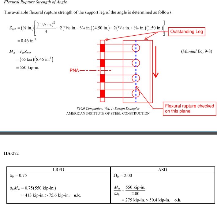

The example goes on to check flexure for one of the angles legs. The calculation uses Zx from the property table, however the Zx neutral axis is about one leg vertical and another horizontal. The connection is positioned with both legs vertical. Why is Zx not calculated like a vertical plate for a single vertical angle leg?
I'm not sure what you're looking at. I'm looking at the 16th ed. Page IIA-271 and 272.
The PNA is horizontal and perpendicular to the supporting girder. Please see below and let me know if that makes sense.
